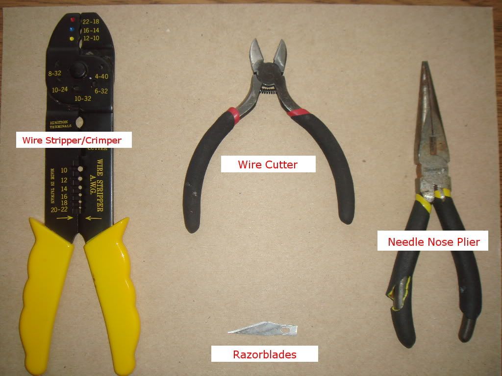

Most basic wire strippers have a crimper in the top portion of the jaws. There are usually three spots to crimp and each of the three spots has a color dot next to it. This refers to the color of the blade connector. So if you get yellow connectors, use the yellow crimper hole.
See the picture below for an example of a basic wire stripper with the crimper at the top of the stripper tool.
http://i50.photobucket.com/albums/f3...Supplies_1.jpg
This is very helpful. Thank you!
