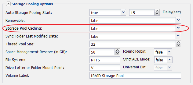

I spent quite a bit of time trying to get tRAID working and I've come to a conclusion: Don't let SageTV use to the pool.
That has resolved all of my issues. I don't know why tRAID's storage pool can't handle SageTV's disk activity, but I've proven that's the culprit. I still think it sucks that I can't use that feature with Sage, but this is an acceptable solution. My "spinning circle" is gone from everywhere; I haven't seen Sage perform this quickly in YEARS. The beauty of this solution is that I can still use the pool for everything else (utorrent, direct rips, simultaneous backups, shared user folders, etc) without any problems and I don't need to play file tetris.
Here's what I needed to do:
1. Turn off storage pool caching (screenshot attached; might need to reboot afterwards)
2. While tRAID is running, go to Windows Disk Management
3. Assign a path or drive letter to each PPU in your tRAID array
4. Ensure your new paths are shared correctly
5. Remove SageTV's access to the tRAID shares
6. Create new, empty folders with the same name as your tRAID shares and give SageTV full access to them (these paths MUST match the ones you deleted from step #5 exactly)
8. Add the individually mapped folders from step #3 to SageTV
9. Run a manual media refresh in SageTV
10. Ensure you have no duplicates pointing to the old tRAID shares and then remove those shares from SageTV
With direct access to the drives, my write speeds are fantastic now, averaging about 60Mbps. Obviously, when I write directly to the pool, it's a bit slower.
Also, if anyone was having issues with the pool becoming inaccessible to other computers, I found a solution here.
