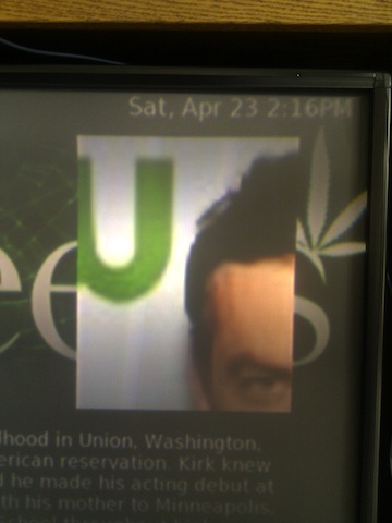

I've looked again at how those pictures are displayed and they're set to maintain aspect ratio and shrink to fit. Can you take photo of what it looks like.
Two examples. Looks like the images are just cropped now. Sometimes they seemed stretched. Probably depends on the original.
The original from IMDB: what I see:

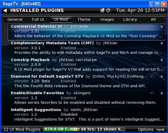

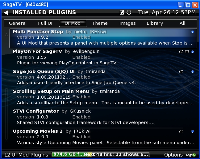

here are my UI plugins:

Finally resolved the issue with the scaling thumbnails. Ran across the ui/enable_hardware_scaling_cache property in another thread, where having it set to "true" was causing some other UI issues for some folks. Mine was set to "true" as well, flipping it to "false" fixed it.
