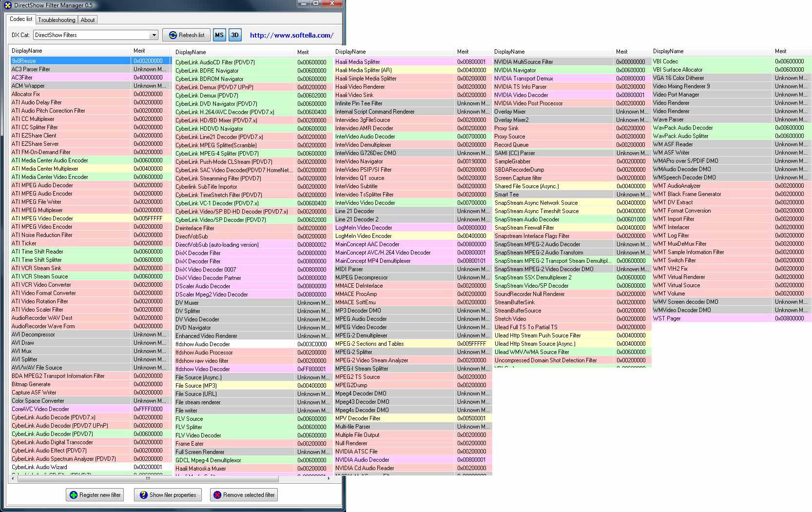

Don't worry about VMR9 or VMR7 etc. You don't need to mess with that. Just make sure Sage is set to use VMR9. As for the other stuff do what I mentioned. Use DSFilter manager and adjust the merits for the codecs I mentioned in the above post to the merits I suggested. Make a system restore point before doing this and that should be able to return you to the before state if anything goes wrong or simply write down what the current merits are before changing them. It isn't doing anything that isn't reversible. I'm sorry but I don't really have the time to post step-by-step instructions

Perhaps this will help. I'm attaching screenshots of most of my merits for various codecs. Use them as a guideline if you like. Also bump up AC3Filter to the HIGHEST merit possible.
DSFilter manager is DirectShow Filter Manager. A quick google will get that for you. Once you have set your merits then reboot and try your playback problem files.

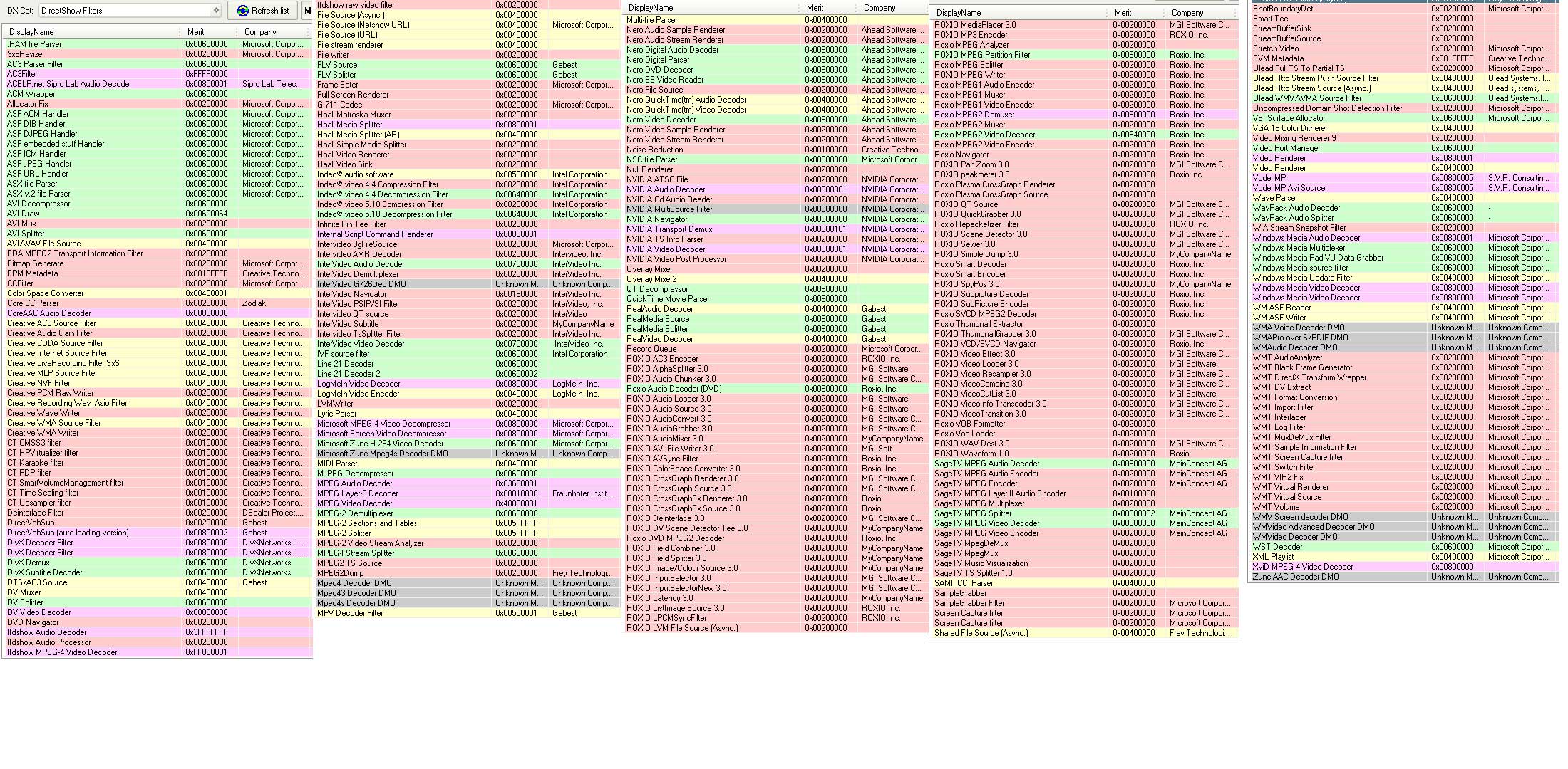

What exactly does changing the merits do? (does it change Priority?)
I don't have 1/2 of the codes your using as high merit, and you don't have 1/2 the ones I am using
I tried to make the high merits match as close as possible, but probably only have 1/3 of the same ones that you have. Only one Roxio was set high.
BTW I still have bars using Sage so I reset to teh system restore point.
Why would sage have problems when all other video players play everything fine?
Since our machines are so different is there a general concept to figuring out what merit should be set for what? I attached my merits after system restore. only thing I changed was the AC3 filter to maximum.

I just want to make sure...you rebooted after changing the merits right? and lowered all the ones I mentioned? It isn't important to run VMR9 instead of overlay...if you are happy with overlay then use it.

also it looks like you raised the ffdshow mpeg4 video decoder instead of lowering it.

No I didn't reboot! l
The above shot is after I used my restore point (so back to default) but i did lower the things you suggested first I just did not reboot before trying in sage!
