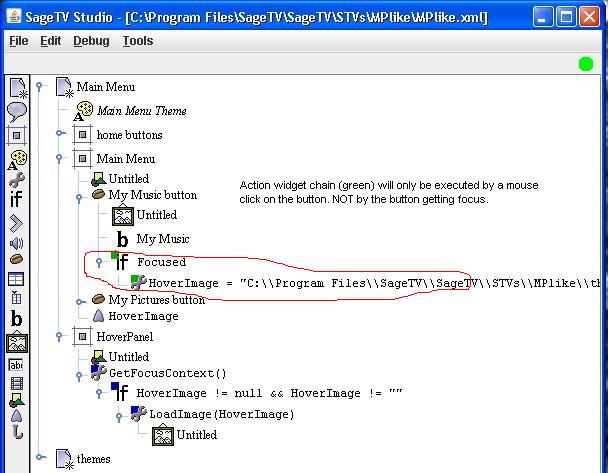

Im trying to implement a simple "rollover" scheme whereas I have a panel with several image buttons in it and as a button is focused another image appears in another panel. This has been asked before and I followed the suggestions in that post, but its still not quite right. When Im in the panel with the buttons I actually have to click on one, then shift focus away from it before its picture appears in the other panel. then of course, its the wrong picture!
Can someone tell me what I've done wrong here?
Attached is a small clip from studio showing the code.
Thanks!
Old 11-05-2007, 04:10 PM
First, you could just set an attribute (variable) under each button, defining the filename of that button's image file. This is probably the simplest solution. Don't put the HoverImage attribute widget under a parent common to both buttons.
Second, the way you have it set up, the code to set the hover image won't get run until you select the item, as you've noticed. To run code when the button gets focus, use the FocusGained hook. (Remember: if you ever do any Refresh or RefreshArea calls in the FocusGained hook, you have to call Fork() before calling Refresh() - there is a sticky about that in this forum section.)
Old 11-05-2007, 09:40 PM
perry59's Avatar
perry59 perry59 is offline
Location: oregon, usa
Posts: 76
Thanks for the help Andy.
I thought I had this coded correctly, like what was described in this post
http://forums.sagetv.com/forums/show...light=rollover
but it wasnt quite there. Not sure why I would have to have a variable under each button if each button had an action widget to set the value of a variable shared by all buttons...
I also assume you mean for the FocusGained hook to be in each button, how is this different from the "if focused" statement?
Anyway, what I did was to put a "hoverimage" variable under each button and under that I put a FocusGained hook and as a child of the FocusGained I added an action widget which call "ExecuteWidget" with my HoverPanel as a parameter. Seems to work great now, and there was no need to call "Refresh()"
PS, is that correct, putting the action widget under the FocusGained hook calling the executewidget code?
Old 11-05-2007, 10:00 PM
You don't need the variable under each button if you are going to set the value when the item gains focus, but only the FocusGained hook's child widgets will automatically get called when the button gains focus. Your action chain under "If Focused" was not a UI chain, since it contained no child UI widgets, so it was an action chain, which only gets executed when the button is selected, not when it gains focus.
If the variable/attribute is defined under each button, then GetFocusContext() will get the variable values for the currently focused item when focus changes & you will automatically get the value w/o needing the FocusGained hook.
See my comment above.
I don't understand... you somehow managed to get the FocusGained hook to be a child of the attribute widget, or what? And, what do you mean by "ExecuteWidget"?
You need nothing under each button other than either 1) an attribute defining the variable for that buttons value, or 2) a FocusGained hook setting the variable's value, if the varibale is defined somewhere above the buttons. (#1 is just easier.)
There is no need for a refresh call since you are using GetFocusContext(). (I shouldn't have mentioned the info about Refresh()... it was just in case you ever tried that call under a FocusGained hook. But, all I did was add confusion, so ignore my previous comment about refresh in this topic.)

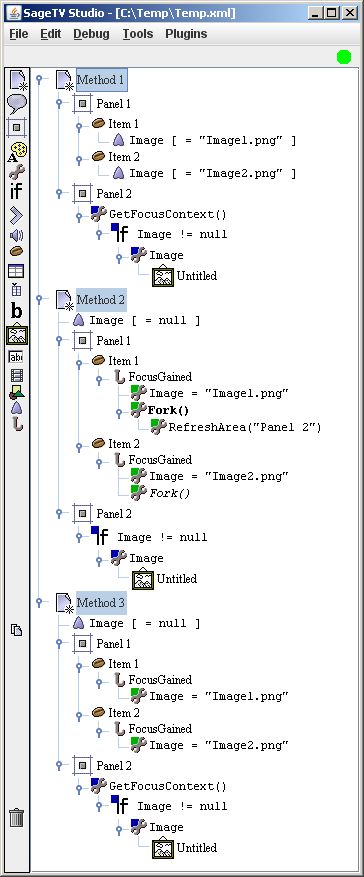

I've attached a screenshot illustrating various ways of doing it.
In method 1, putting an attribute under each item lets you define the attribute values statically (as shown in the square brackets) and enables GetFocusContext to automatically select the appropriate value for the focused item without any additional code on your part. Think of this as the object-oriented approach, with each item being like an instance of a class with a property called Image. Each instance has its own copy of the property variable. The code under GetFocusContext is effectively invoking that property on the focused item.
Method 2 is more of a procedural style of coding. There's only one attribute, defined at the menu level where everyone can see it. Event handlers under each item explicitly set the attribute value and explictly call RefreshArea on the panel that needs to be redrawn as a result. There's nothing for GetFocusContext to do in this case, since the context for all items is identical (i.e. no item-specific attributes).
Method 3 is a sort of hybrid approach. It still uses the procedural method of choosing the image as in method 2, but exploits a side-effect of GetFocusContext to get Panel 2 refreshed, instead of calling RefreshArea explicitly. I consider this method a bit of a kluge on two counts: First, it's using GetFocusContext only for its side-effects, and not for its primary purpose (retrieving the item context, which in this case is the same for all items). Second, it assumes that the FocusGained hook will fire before the refresh entailed by GetFocusContext. This assumption may very well be correct, but it's an additional timing dependency that neither of the other two methods has.
So my preference would be for method 1 as the simplest and most straightforward expression of the intention. Method 2 would be an acceptable (if rather more verbose) alternative. Method 3 I would tend to avoid for the reasons given above.

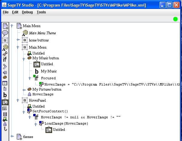

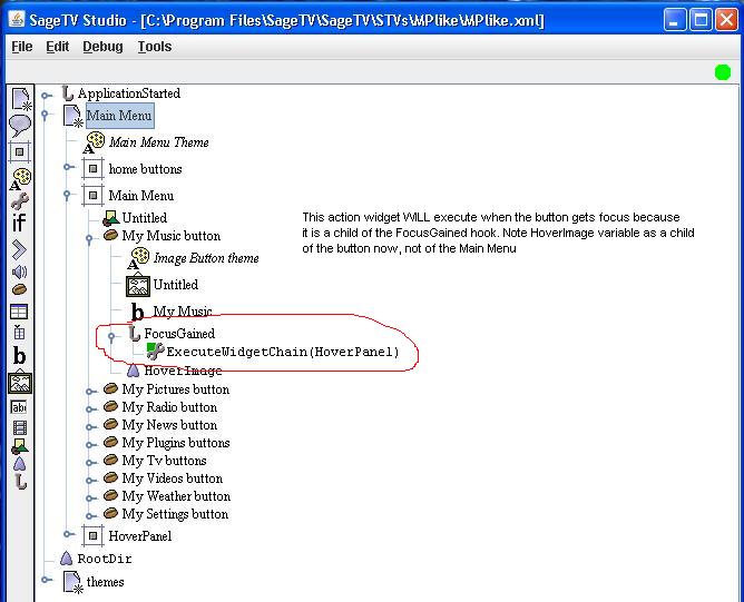

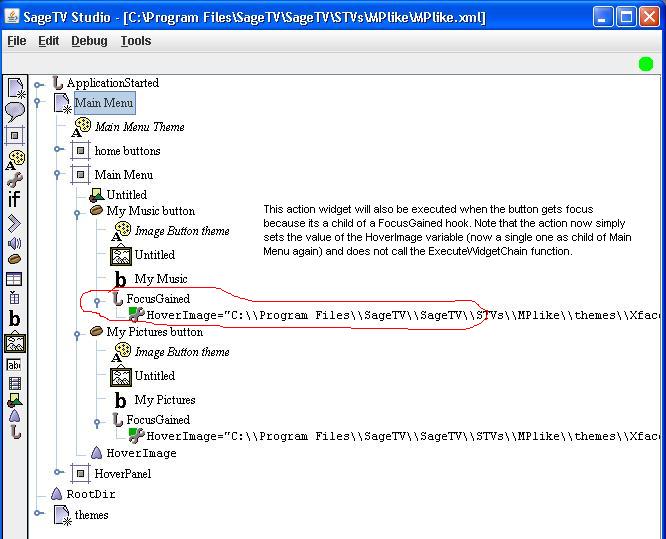

Greg, as an aside, I downloaded your studio tools. Put the .jar file into SageTv/Jars and the "gkusnick.sagetv" folder into the SageTv folder (right beside the Jars, STV's, etc folders) but I see no other options in Studio.
What have I done wrong?
Thanks

Just in case you haven't figured this out yet, the ExecuteWidgetChain call in your second try doesn't do remotely what you think it does. For one thing, it's expecting a Widget object as an argument, and what you've passed it is basically null, i.e. a reference to a variable (HoverPanel) that's not defined anywhere. Simply naming a Panel widget HoverPanel does not declare a variable of type Widget with a reference that panel as its value. Only Attribute widgets declare variables. In order to get a Widget object to pass to ExecuteWidgetChain, you would have to use WidgetAPI calls to navigate the widget tree.
But in any case, ExecuteWidgetChain isn't really what you want here. It's meant to apply to Action chains that calculate values and is mainly used interactively during debugging. To refresh a UI widget, use RefreshArea (with the caveat that Andy mentioned earlier about forking when called from a FocusGained or FocusLost hook).
Misusing API calls generally results in exceptions being thrown. To see these exceptions, make sure the Notify on Errors checkbox is checked on the Tools menu in Studio. To see a stack trace, check your debug log, or run with a console window open. You can enable the console window in the registry as follows:
