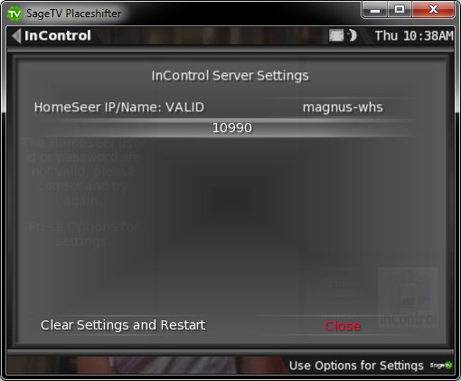

Yes, sorry for the delay, my 30 day trial was up so I had to renew the license. This is what I see, and it's the same on the Client, the HD200 and the PlaceShifters.
Another question: Do I need to have a separate port for each client/extender/placeshifter I intend to use with InConrol? I wouldn't think so, but I have to ask.

Moskus,
Did you try to Clear All Settings?
Any way you can enable debugging on both HomeSeer (InControl Settings Log Level=3) and Sage then restart both and get to this screen?
Also, been busy working on version 1.3 which will provide a System Info screen that will also help me debug connectivity problems. This version will also allow HomeSeer to control Sage .
