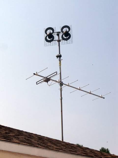

DIY antennas rock. Here's my Orlando antenna on top (Antennas Direct C4) and my DIY Yagi underneath, pointing towards Tampa. I cut it specifically for CH 10/11 (VHF). It's my second attempt at a DIY antenna and it works very well. It boosted the signal about 10% over the C5 that was there previously, according to the HDHR software. It was a fun and satisfying project.
