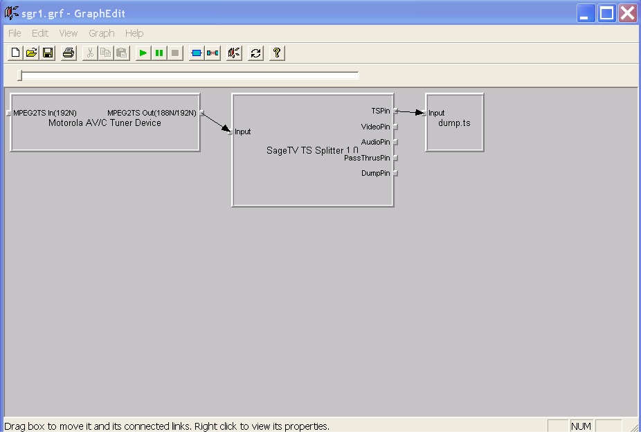

I've attached a screen shot of the graph to this post. It's a pretty small change to the graph. Now my firewire recordings come out as program streams and playback works much better on my software client. |

Thanks that works pefectly I made one change to my ini and that made channel changing seamlessly. I unload the graph after channel change and stop. TuningDelay=5000 UnloadGraphOnStop=1 UnloadGraphOnSwitch=1

Make sure you register the dump filter that came with SGraphRecorder and use the SBDARecorderDump directshow filter not the MPEG2DUMP as output.
