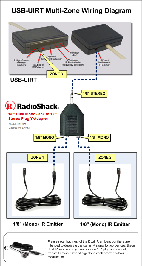

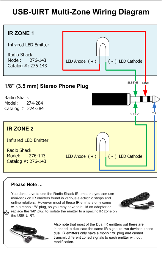

Originally Posted by sflamm View Post
Does this mean that it is not possible to have 2 STBs each with an HD-PVR and the built-in IR blaster?Is the USB-UIRT the easiest most reliable way to get things working properly? Where can I find directions on setting it up?
These two diagrams should help you understand the physical USB-UIRT multi-zone hook up.
Dave

Thanks so much for the diagrams.
I have a few mono IR emitters lying around - so it looks like if I just plug them into a stereo to mono splitter (which I also have) then I should be able to support 2 zones, yes?
What do you do if you end up with more than 2 STBs? Does the USB-UIRT support more than 2 zones? Does SageTV support more than 1 USB-UIRT?

The USB-UIRT has three zones. One zone is in the main USB-UIRT box, the other two zones are used by connecting to the jack on the box. I used old Hauppauge IR LEDs, cut off the connectors that did not work with the USB-UIRT, and soldered both IR LED cables to a stereo connector I bought from Radio Shack. They have a metal jacketed and cheaper plastic jacketed stereo connector. I used the better quality metal jacked stereo connector. You can take the USB-UIRT to Radio Shack to make sure you get the correct connector.
I think this may have been the connector:
http://www.radioshack.com/product/in...ductId=2103990
More information about setting up the USB-UIRT for multiple zones is here:
http://forums.sagetv.com/forums/showthread.php?t=5291
The Shadeblue.com grahics I posted earlier are posts 105 and 106 of the string. If the set top boxes have multiple IR channels, then you can control many more boxes. For example, if your set top box could be setup with 4 different IR codes, then you could have 3 x 4 = 12 set top boxes all controlled by one USB-UIRT. Each set top box that uses the same codes does have to be optically isolated from other similar set top boxes. The USB-UIRT is the best option for being more flexible to change service providers. If a service provider jacks up the rate, you need to be flexible to switch providers when the price increases exceed your personal thresholds.

Sorry i think that confusion is partially my fault. I didn't specify the non copy protected content, just reffered to it as 5C encryption which isn't 100% complete or correct.
Sorry everyone...
sflamm - I just recently installed a USB-UIRT and found the following post extremely helpful...
http://forums.sagetv.com/forums/show...usb-uirt+multi
9th post down...
~Pix64
