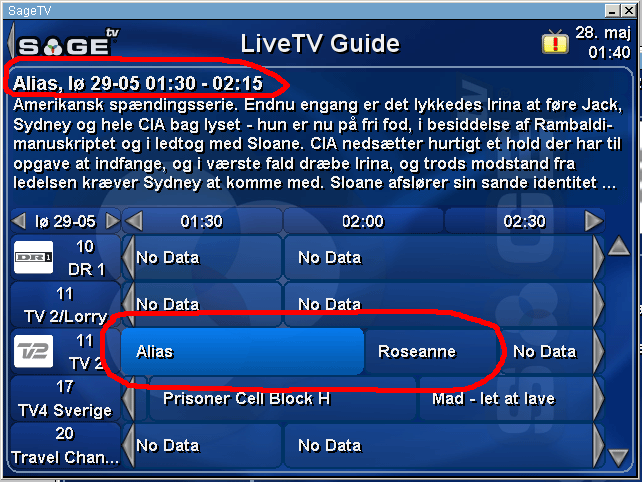

I have now been playing around with Sage TV 2.0 for a couple of days now, and the product really rocks !! I'm very familiar with XMLTV and how to use it , but when importing data into Sage TV, its somehow with an offset of 24 hours ?? Example, where you can see a snippet of the first 2 progammes in the xml file : <programme start="20040528013000 +0200" stop="20040528021500 +0200" channel="001.tv.tv2.dk"> <title lang="da">Alias</title> <programme start="20040528021500 +0200" stop="20040528024000 +0200" channel="001.tv.tv2.dk"> <title lang="da">Roseanne</title> As you can see, the program "Alias" should air at 01:30 at the 28. of may 2004, being followed by "Rosanne" ... but in my TV Guide in Sage TV, this entry (Alias) first comes up on the 29. of may 2004 at 01:30 ??? (se screendump from Sage TV) Is there something that i have missed out ? Any settings or ? Hope that someone can help me figure out what is wrong ... Regards from Denmark, Kent Fonager, Copenhagen |

As you say the XMLTV data is correct, with the correct time format, so it is not a data problem, so either the plugin is parseing the wrong date, or Sage has a big problem in displaying the date... Which xmltv plugin are you using (there are several, one of the better ones for European users is in the UK forum)? Check setup/system info to see when the last EPG update occured, and maybe force an update by going into setup/channels and removing/re-adding a channel. Also try using the plugin tester to see if there is maybe a problem later in the XMLTV data preventing the import from being sucessful.

I was using the plugin from this page (refered to by sage support page) : http://mta.techno.org/epg/ I've now installed the plugin at the page you refered to and have deleted the wiz.* files and tried to import everything again. And now it seems like its working as expected. Perfect ![]() I'm now just wondering if its because i started all over again deleting the wiz.* files or because I installed the new plugin ... But thanks for you reply, now I'll continue using the sage product ;-) Take care and have a nice weekend, Kent Fonager Last edited by fonager; 05-28-2004 at 04:19 AM. |
