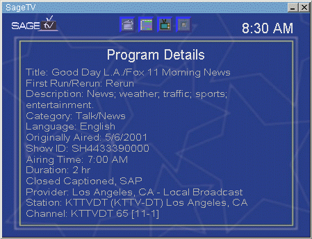

To tell what channel it is in the guide, go to its Detailed Info. See the attached image.
You need to have the DTV stations enabled in your lineup to use them. You can do this in channel setup.

Ok, it looks as though in that picture you set up Los Angeles, CA - Local Broadcast as a service to get the digital stations.
If I try to set up Chicago, IL - Local Broadcast, it knocks out the DirecTV because it is using the same input (S-Video). Also, when I do that, I still do not see the digital stations at all. I must be missing something...
