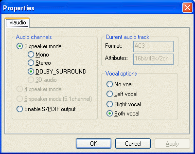

I have Sage set to default and still nothing.
This is what shows up in WMP.

My guess, is you need to uninstall whatever that is, because it's keeping you from using the nVidia decoders...just a guess though.

So I unregistered iviaudio.ax. . . It was an intervideo decoder. An old installation of WinDVD was hijacking my system.
Now I get the proper PureVideo window in WMP, but still no system tray icons. It's not a big deal as everything is working properly otherwise, just kind of annoying.
