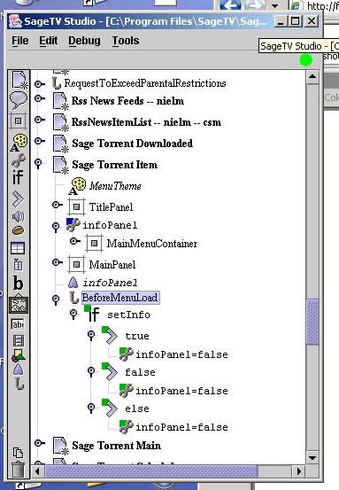

I'm trying to modify a local variable depending if the prior menu has a certain setting set. I'm using AddStaticContext(...); so I can pass the setting from menu1 onto menu2. I tried using BeforeMenuLoad hook which checks out the variable set by AddStaticContext, and then modifies my local variable depending on what menu1 did. However I can't seem to make the setting stick, or it's not going through....
Anyone tell me how to set a local variable before my panes are drawn on the screen? I also tried GetFocusContext() which also didn't work. -- FC |

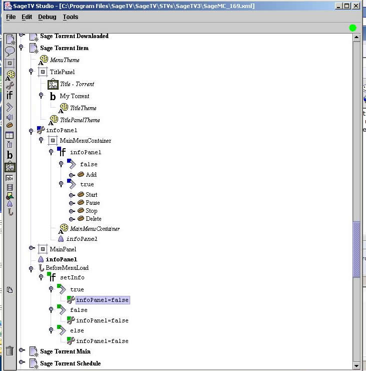

What are you trying to do with infoPanel? It is being set to false, but the pic only shows it being used leadinginto a panel... did you mean for that to be a conditional before the panel?

Why do you have a second reference to the infoPanel attribute under your MainMenuContainer? By doing so you've effectively declared another variable called infoPanel masking the original infoPanel (the one you've initialized in BeforeMenuLoad).
I'm also not clear on why all the branches of your setInfo conditional do the same thing, or why you even need that conditional at all. If the idea is to initialize infoPanel to the inverse of setInfo, just say !setInfo directly in the attribute widget's Value property. Also, just as a stylistic point, I prefer to arrange the widgets in the order they execute, i.e. attributes first, then BeforeMenuLoad, followed by the actual UI widgets. It doesn't matter to the code, but it does matter to the human being trying to read it and make sense of it.

THANK YOU guys.... I got it working once I removed all the instances of infoPanel. Apologies for the questions, I'm very new to SageTV Studio, a bit confused how it all works (but learning). I was under the assumption that it worked like a programming language where you need the variable declared in every nest.... I did do the tutorial and read the docs, it's just one of those things that I missed....
BTW I can't set infoPanel to setInfo only because there are some entry points into this panel that do not set infoPanel to anything... hence the "if" statement for BeforeMenuLoad -- FC |
Attribute: infoPanel Value: If(setInfo != null, setInfo, false) Or something like that. I'm not saying you have to do it this way. Obviously if your initialization logic doesn't fit neatly on one line, you're better off coding it using Conditional widgets. I just wanted to make sure that you're aware that (a) you can use arbitrary expressions in the Attribute widget's initial value, and (b) there's a one-line If function that's (somewhat) analogous to the ? : operator in C. (Actually it's more like VB's Iif function in that all arguments are evaluated.)

Sounds good... another thing I didn't realize is that although the variable is seen as a "reference" it's actually not referred to... like a pointer. I had (in my original source) the same attribute in various sections, assuming the attributes were the same one (kinda like a pointer), so once I changed it on the BeforeMenuLoad hook it would stay no matter where I placed the attribute. Maybe I'm off on my whole logic, but it works, that's the important thing to me right now.

No, a widget reference is not like a runtime pointer to a shared variable. It's more like a #define in C, a way of inserting multiple copies of the same code (or variable declarations) in several places, without actually having to copy and paste the code (and manually maintain all the separate copies).
