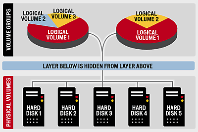

Linux Logical Volume Manager???
Link....http://www.softpanorama.org/Commerci..._manager.shtml
I wonder how this might work in Linux? Anyone work with the LVM in linux?
Seems like an aweful lot of information to just share a bunch of drives.
I have worked with Linux in the past, but am no guru with it. hmmmm

DFS doesn't aggregate physical drives into a single large logical partition. What it does is to make network shares on different servers appear as folders under a single logical share. You can specify more than one target for a DFS link, but that doesn't pool the storage from those targets. Multiple targets are assumed to be mirrors of each other; when you refer to a link, the DFS client selects one of the targets (generally the one topologically nearest the client) and ignores the rest. So I don't see how DFS is going to solve your problem.
You might take a look at Windows Home Server, which is probably closer to what you're trying to achieve.
