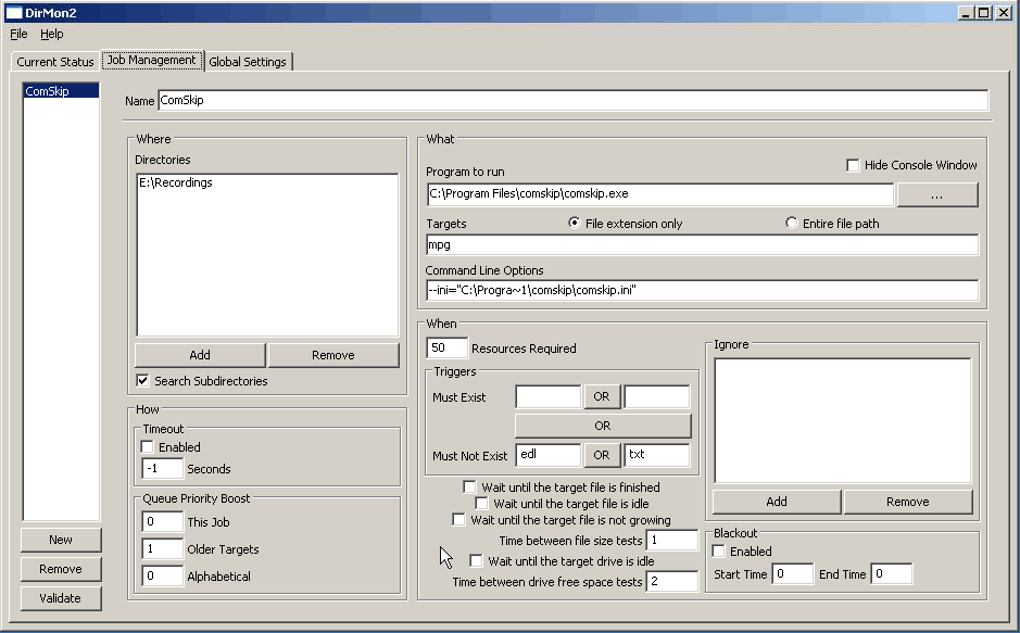

Dirmon2 Problems
Hey guys I am having trouble using TWO computers to do comskipping...
It seems that dirmon isn't paying attention to the .edl file that is listed so both computers end up ComSkipping the same mpg.
Attached is how my stuff is setup.

Are you sure that is working at all... you are missing the mpg in the must exist, maybe its not necessary.
Are you using show analyzer? There is an option in there "When" to create the file (when beginning or when done) do you have this set to when done?

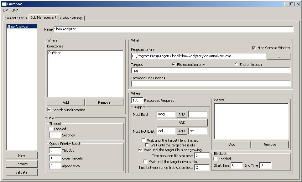

I also had two separate computers to do either comskipping or running showanalyzer, before I got a fast dual-core, which can run showanalyzer at any time without degrading my SageTV performance. I have a suggestion for the DirMon2 configuration and a method to run comskip.exe on your SageTV computer without killing the SageTV performance.
I noticed that your "must exist" does not have the "mpg" parameter.
I included a screenshot of my DirMon2 configuration.

As long as the target is set to mpg the must exist can remain blank. I think the main problem assuming your comskip creates the edl as soon as it starts is that you set the not exist to OR instead of AND. Basically the way you configured it is if Either the edl or the txt don't exist then it will process. You only want to process if they both don't exist thus the AND.
The only thing I'm not sure of is that I'm assuming your comskip outputs just the edl and no txt right? If that is the case then wouldn't it just keep processing them over and over again and keep recreating the edl since the txt would never exist?
It says ... edl OR txt ... the larger OR shouldn't matter I would assume... and regarding the creating of .edl files, tried it and it DOES create the edl file immediately (and I even gave it some time on the next computer to make sure).

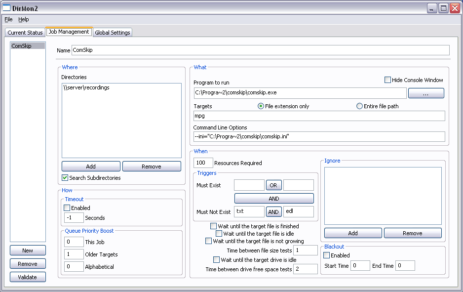

OK I figured it out (and it is something kinda silly).
"CLICKING" on the word OR is what makes it OR not reading it as it is displayed. Rather confusing might I add (and frustrating that I spent so much time and didn't think about it).
Attached is the "OK" config

This is exactly what I said to do in my post. Clicking the word OR changes it to AND. In this case edl OR txt means if it doesn't find either a txt or an edl then it will run. When you change it to edl AND txt then it means both have to not exist in order for it to run.
I'm not sure what you found confusing? The idea that you could click on the word to change it to AND or the way it reads? I guess I'm confused
