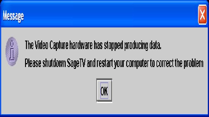

I got the error again, this morning. Stuttering playback was in foreground, and when I switched applications, the error came to the fore.
I closed the error window, closed Sage, which did not die gracefully; I had to kill the process...which didn't kill it. At this point, I started downloading the latest drivers from Hauppauge. Half way through, the machine rebooted due to a hardware driver error (a-ha!). I ran the driver removal application, installed the new drivers, new WinPVR software and decoders. Sage isn't finding any tuners. I'd like to say I'm having fun, but I'm not. Thanks for putting up with my grumbling... --Mike Last edited by Llamas; 02-01-2004 at 12:01 PM. |
