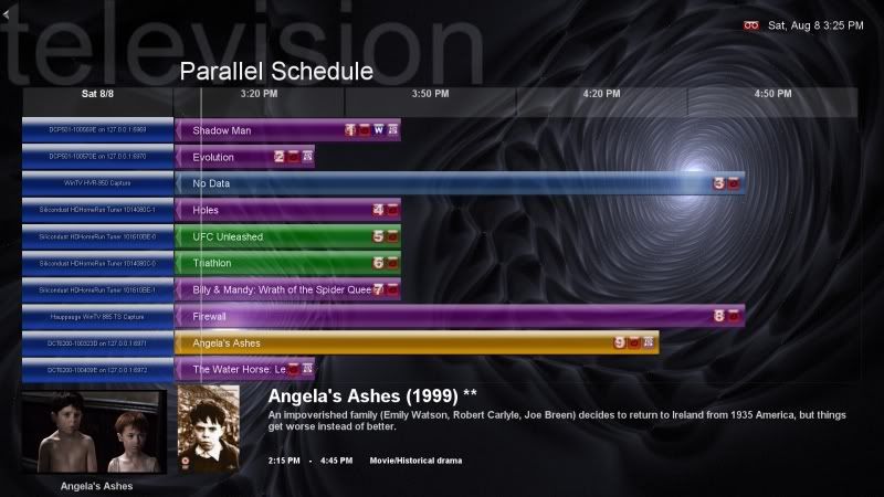

mkanet's Avatar
mkanet mkanet is offline
Join Date: Feb 2004
Posts: 3,359
Here it is in action right now with all 10 tuners... while I FF/REW Angela's Ashes movie.
