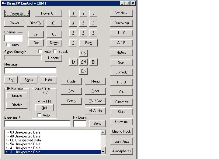

I am using the patersontech serial to usb cables to change the channels on my DTV D11 STBs, everything was working fine. Come home from work this evening and nothing. Sage just flips back and forth between the 2 boxes I have connected.
I tried using the TV Translator to verify the cables weren't cooked, but they both pass the connectivity tests, they are both set at the default settings on patersontechs site. If I try to connect using Directv Control it connects to the STBs but the information window at the bottom just scrolls:
<--75 unexpected data
<--D6 unexptected data
<-- FD buffer overflow
<-- F2 processing
so on and so on... It won't power the STBs on or off. I have tried numerous times to reset the the boxes, power them off power them on, but no love....

I did! No go, if I try using Directv Control I get the scrolling messages at the bottom. I've attached a screenshot of it. Doesn't matter what setting I try, old, new, d10-100, d10-200.
