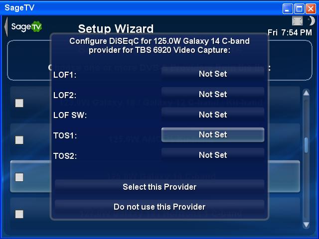

I bought 2 of these cards (got them cheap so took a risk really) they get recognised in MCE but dotn find any channels. http://www.amazon.co.uk/Definition-D.../dp/B002GIPK6I Made by TBS model number 8920. sage TV might be the solution for me, I will buy it if it works (because it seems great, and will save me buying new hardware) Sage see's my card, sees it as DVB-S and lets me choose the correct satalite (28.2E), then it shows a window asking for several frequencys, ive no idea what it wants here, or what any og them mean ? I leave that blank and pres Ok then it fails to find any channels. scanning takes a few seconds and it just says it didnt find anything. Any help appreciaed , I have 21 days to get SageTV running as I would like it to before I decide to buy it, the place shifting and server/client model are brilliant so hopfully I will get there :-) |

LOF1: Lo MHz for LNB LOF2: Hi MHz for LNB LOF SW: 0=22KHz tone off(uses LOF1), 11700=22KHz tone on(uses LOF2) Diseqc switch port 1: TOS1:A TOS2:A Diseqc switch port 2: TOS1:A TOS2:B Diseqc switch port 3: TOS1:B TOS2:A Diseqc switch port 4: TOS1:B TOS2:B Try connecting the coax cable from the TBS card directly to the LNB. Then try these settings: LOF1:9750 LOF2:10600 LOF SW:11700 TOS1:Not Set TOS2:Not Set Last edited by 49studebaker; 10-09-2009 at 07:30 PM. |
