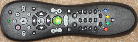

Question Newer Hauppauge 2250 Remote Problem
The attached picture of a remote came with our Hauppauge HVR 2250 card. There are 45 buttons but it does not seem to fully work with SageTV and the Hauppauge 45 button remote selection. A few of the basic default buttons work but the configuration within SageTV will not recognize all the buttons as we try to link other commands.
I found a Old Thread about the "new" 45 button remote from Hauppauge and i was going to try the config from it, however its from 2004 and the picture attached to that thread does not look like my remote.
I wondering if anyone else has a remote like this, and if they where able to get it to fully work, and if so how.
Thanks

It is an MCE remote, I have the same one. There is an MCE remote option in SageTV, but I never tried using it. I use LM Remote Keymap to customize all the buttons and have it use the blaster to controll my TV.
That works much better, Thank you!
What is this LM Remote Keymap, and where can I find it, and what does it change for SageTV's MCE Mapping?
I would like to be able to remap all the buttons and it seems that some of them cant be remapped with the MCE selection.
All I really want to edit is the Watch Live Tv Button, I want it to Pull up the MediaCenter-Videos instead since thats not one of the buttons and something we will use alot more.
Look at my signature for LM Remote KeyMap. What it change is that you must not select a remote within SageTV and remap all your buttons within LM Remote KeyMap.
You may or may not be able to remap all buttons (some MCE remote buttons can also be remapped by keyboard software for instance)
