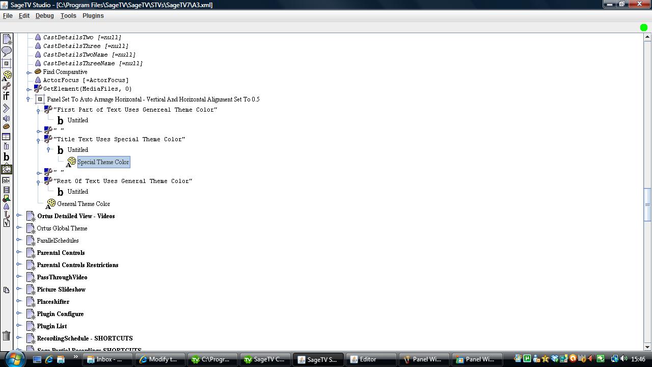

You could try something like the attached screenshot......but it may not work all that well with shrinking text.

I would do it like so using string contains direct in java
if (calltocheckstringforcontains(String)
 >true
     SplitString = Call to sepearte string out
         Call to get First String Element
               TextWidget
         Call to get Second String Element
                  TextWidget
        If(HasThirdElement)
           Call to get Third String Element
                 TextWidget
 >else
   String in action widget
         Text Widget
That is how I would do it split the string. You should have a max of 3 strings and check each element for the match value in the theme.
That should work

Take this with a pinch of salt as I'm only guessing but wouldn't the spacing be dynamic...... so leave the cell sizes blank in Studio and manually add a space into the array so spaces appear before each black text element and before every red text element. Not quite sure that makes any sense as I can't even work it out in my head now
I'll shut up now.

Yeah that is what I was getting at just make the panel horizontal alignment and leave the rest blank and it should be dynamic from there.
