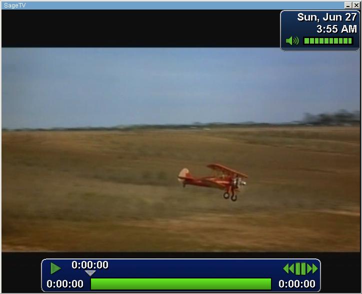

Imported video files time incorrect.
Hi,
I have noticed when I use a temp network drive for storage to DVD, I can't use Imported video files normally. The video will play but I can't seek because Length, Current time are all 0:00 (See Attached Photo). If I move the file back to Sage, The video will seek as normal.
I use the following menu selection: Media Library->Imported Video Files. My import directory points to a network drive like z:\Videos. This folder is where I keep the videos until they get put on DVD (Temp storage). I would like to access them normally until they are put on DVD.
This does not happen to all videos and it is confusing me. It seems to me the video needs to be at least 1 hour in length before this will happen. However, I have seen one 30 minute show do this so I have on clue.
Any ideas?

I am using Sage TV v2.0.19.

Zero length files tend to be because the file was not complete or not readable when Sage scanned the video folder (which it does regularly) and found the new file. (at least that has been my experience!)...
This will happen more often if the creation of the file takes some time (eg copying to a network drive) because Sage rescans the video dir while the copy is taking place
My way of avoiding it is:
* copy/create file outside of Video Library directory on same drive
* move file into Video Library directory
or
* copy/create file in Video Library using temp file name
* rename file to correct name
Both methods mean that Sage will only see the file when it is complete, and so will be able to open it and see the correct length.

Nielm,
Thanks for your reply as it seems everyone else has ignored it.
Every file is complete. As I said in the earlier post, if I move the files back to the server video folders, everything works as expected. This does not happen in previous versions of Sage.
I set my favorites to limit recorded episodes to 15 so I can't add the drive to the video folders and can only keep it as in imported folder so SAGE won't start deleting saved episodes.
This also happens when I put a software enoded file to the archive folder. I know that is complete and not damaged in the copy, it is in its original location.
Here is something for you to try. I have done this and it didn't damage my files in later versions but if Save is modifying the headers (which I doubt) it might).
1> Change your video directory from a "Video Directory" to a "Library Import Directory" in Sage Setup.
2> Refresh your import new Library Folder
3> Play each video paying attention to the Length Sage says it is.
Note: All videos will play in their entirity even though Sage indicates to you they are 0 byte files. What you lose is the ability to seek through the file.
I have tried on several ocasaions to refresh the video library. Save should read the file when you hit play and not store length.

The files may be complete when the copy has completed, but the copy itself will take a certain amount of time...
If Sage scans the folder while this copy is still in progress, it will see an incomplete file and will be unable to determine the length, and so assumes length=0.
Sage stores the length of video library files in it's DB (it shows up in the video library/detailed info screen), and does not re-determine the length of 'known' files if you play it, nor if you re-scan (it only looks for new files, which is why renaming fixes the issue).
I might try what you suggest tonight, but I would expect lots of side-effects to changing my video directory to a library import directory. For one Sage will no longer think that those files were ones it recorded, and it will remove all those files from the 'Sage Recordings' menus, (thus breakign auto-delete, keep at most, etc).
One thing for you to try:
* Find a file with 0-length indication
* Rename it to a different name
* Refresh library folders
(Sage should see the new file name, and try to determine its length again).
* check the length in the video library/file/detailed info page
* check the length on playback.

Thanks for your help, If I wasn't so bullheaded I would have tried your suggestion before replying. It works.
When did Sage start updating the folders automatically and how do I turn that off?
