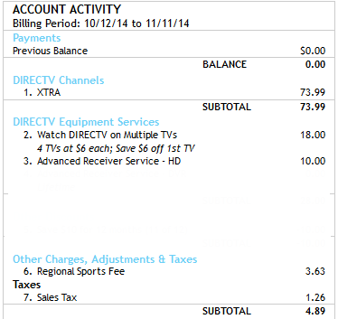

EPG Service would be the same as before. You would probably need to change the tuner setup settings so that you pull the DirecTV EPG. 1 thing to be aware of, you will need 1 STB per tuner which means additional fees. 1st STB no charge, additional STBs have a monthly fee |
