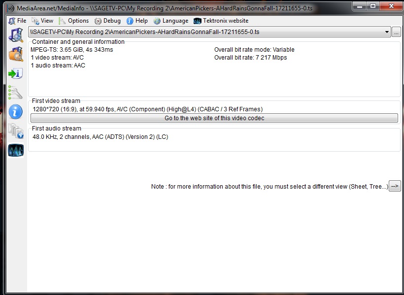

Here one If you look at the time index you see it a miles off which should 59min Also the Audio should have been AC3 Steam. |
