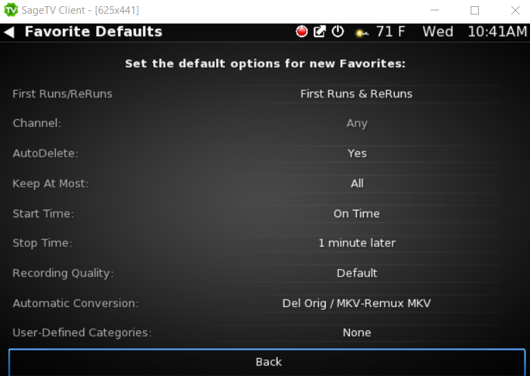

Old 06-02-2021, 11:43 AM
Originally Posted by trk2 View Post
Stream copy as ffmpeg calls it. Been looking forward to that feature for a long time.
Right now these are my favorites defaults to remux to MKV and Delete original ...
