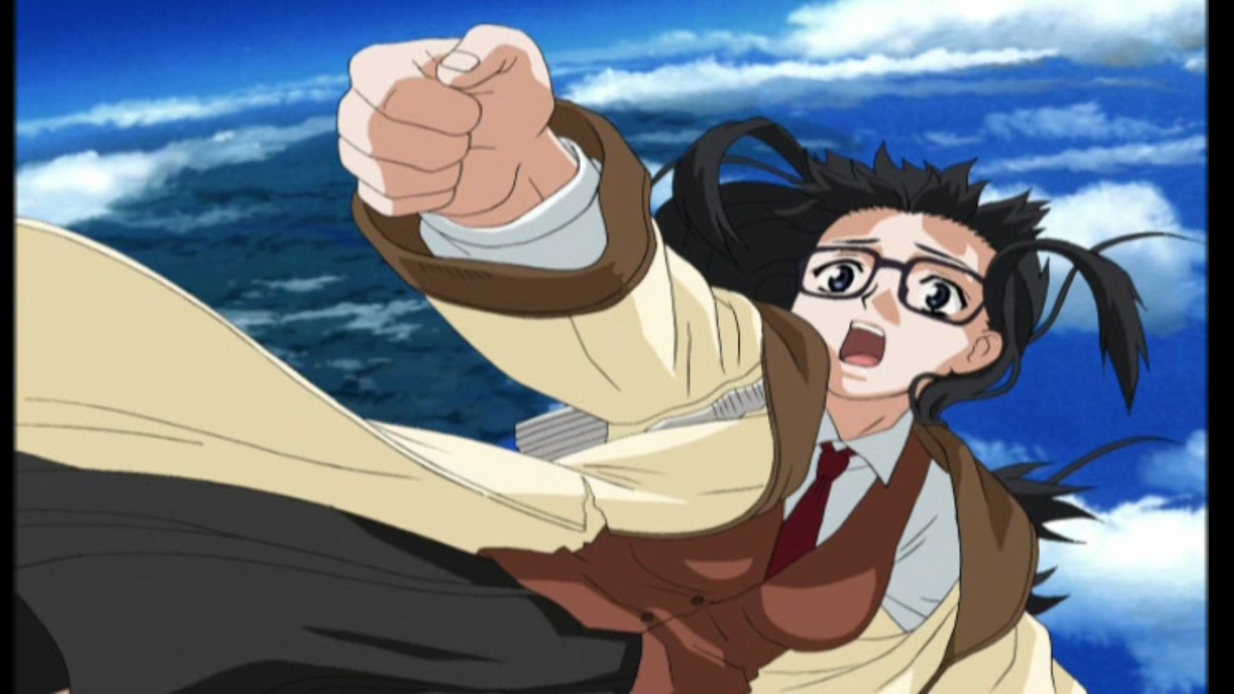

FWIW, seems like as good a thread as any.
For those of you who are curious...
I posted a screenshot recorded with my 250 off cable here:
http://forums.sage.tv/forums/showpos...8&postcount=63
Well I have since purchased the DVD and took the attached screenshot, shows you what's possible with the 250
I'm a little surprised myself, but it looks like I need to re-calibrate my capture settings
