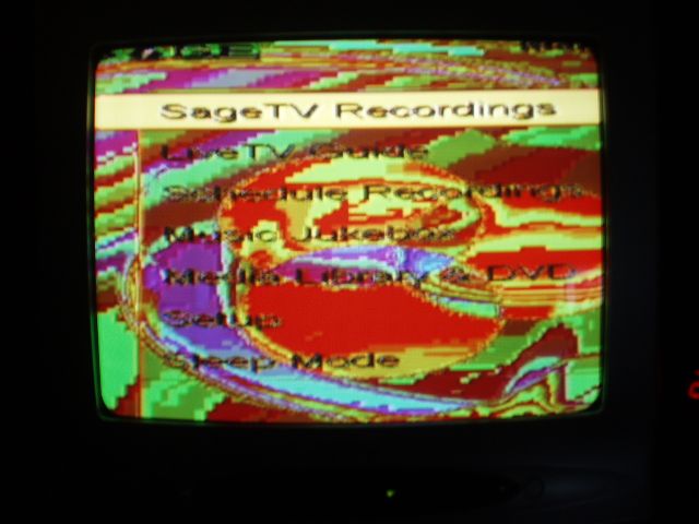

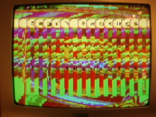

Hi,
I bought a PVR-350 a week ago, and have been messing since. I can`t get the TV-out to work with SageTV, wich seems like the best programm for me. I have tried GB-pvr, wich displays a perfect osd. SageTV, well, it doesn`t really come up to GB-pvr`s standards ![]() Look for yourselfe in the images. My specs: P4 2.66, 512MB, Geforce MX440, Wintv PVR-350 using pvr-350`s tv-out on: Pal_B tv via composite > scart. Anyone have an idea what might be wrong? |

So you're in PAL land? what you're seeing doesn't necessarily look like an NTSC signal on a PAL screen. How'd you get that screenshot? Is it through printscreen, or some other means?
I see in your shot that you can see a little of the GUI. If you can get to the setup menu, try toggling the 350 output settings GUI, and output enable/disable. Enable hardware decoding only. Search the boards for 350 related PAL settings, unfortunately I'm in NTSC, so I know very little/nothing about setting Sage up for a PAL world. |
I got the screenshot by just photographing my tv screen with an digital camera.
I can see a little of the gui indeed. Luckely, the osd is displayed on my monitor too. Looks perfect there. I`ve tried all the combinations with the hardware decoder setting, the switch on tv-out, and the osd on tv-out settings. Didn`t help. |

My motherboard came bundeled with an overclocking for noobs programm CoreCentre. I overclocked my 133fsb to 140, just to test what it would do. As it turns out, my PVR-350 didn`t like this. When I turned this back, everything went back to normal. |
