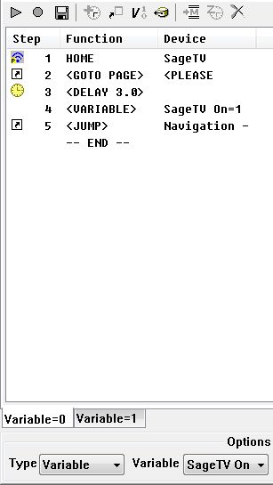

Each device has Power On and Power Off variable based macros (I make these separate from the "native" On and Off commands so I can debug things using the real On/Off commands if I need to without the macros making things difficult. Essentially the logic is:
if <device on> == 0
   Power On Command
   Delay until device accepts commands
   Set <device on> = 1
else
   do nothing

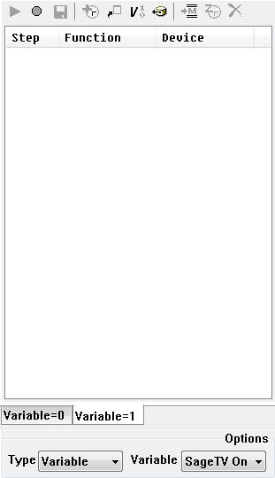

For SageTV I have two buttons Power On and Power Off that are Variable based macros:
On:
Off:

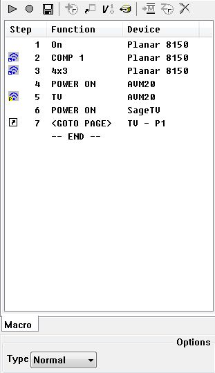

Then my "TV" launchpad (first Watch screen) has the following macro:
I have similar macros for stuff like staring my Blu-ray player, Xbox 360, etc.
