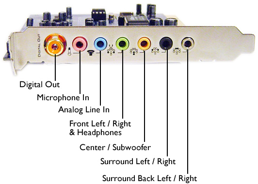

To send 5.1 sound to your receiver you will need to do one of 3 things: 1. Connect 3 analog cables, one for FR/FL, one for RR/RL, and one for Center/Sub 2. Connect an optical spdif cable 3. Connect a digital coax spdif cable You say that when you are playing a DVD it says "Digital" on your amp. Are you playing the DVD from your PC or from a seperate DVD player? It sounds like you have your PC configured to send 5.1 sound but you only have a single analog cable connected so only the FL/FR channels are actually making it to the amp. -Striker- |

I selected and configured the AC3Filter. Then realized from Striker's comments realized that I didn't have the proper cables connecting the SageTV client PC to the amp. I only had a single analog cable running from the PC to the amp. I didn't have digital output on the sound card so I used Striker's suggestion and ran three analog cables from the PC to the amp. Now I know what all those output jacks are used for on the sound card. The proper PC to amp connection required three mini-jack to RCA adapters/cables connected to the DVD input on the amp. The DVD input was the only place available on the amp to connect front, side and center RCA audio inputs. I was surprised that after doing this there was still no voices from HDTV shows with 5.1 sound. By trial and error and pushing lots of buttons on the amp I realized that the Audio Selector on the amp had to be changed from "Auto" to "Multi-Channel". So in a nutshell, the solution was to use the AC3Filter, the proper cables from the PC to the amp, and configuring the amp to receive Multi-Channel audio from the analog inputs. Thanks very much for your help! Quote:
