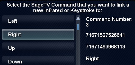

I'm not sure if I explained myself well enough. Your remote is sending two commands and alternating between them for the same button press on the remote. So, you don't need Sage to ignore one of them. What you need is for Sage to know that BOTH of them are for a single button. See my attachment to see how every Sage command linked to a button should look. The long numbers are the two IR codes my remote sends for that single button.
Now, if SageTV winds up acting twice on a single command, that's a different issue, but that didn't sound like what you were experiencing.
When doing so it takes up extra time, makes the TV display go black for a few seconds as the TV is figuring out what to do and then the TV displays the Input menu till it times out. It's just a process not needed. I've added the TV as a device but don't have it assigned to any activities. I just have a soft button assigned for power toggle and input.
If you only ever use a single input on the TV, then try deleting the other inputs in the Harmony software. Maybe that will stop it from trying to change them.

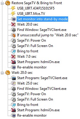

I'm running EG myself and can tell you that it has some great features. What you're looking to do is quite easy, too. I'll attach what my EG file looks like, so you can get an idea of what you'll need to take under consideration.
