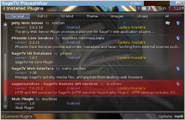

This is a post on setting up the sagex-apis (Sage Remote APIs) so that you can develop the java portion of your customization, and fully test it, without having to build and deploy a jar to SageTV. Building and deploying a jar, and then restarting SageTV to pick up the changes is time consuming, and your time is better spent writing code
![]() Overview First, just a quick overview of the sagex-apis. This is not a new plugin. This is the first plugin that I wrote when I started developing for sagetv, because I needed a way to develop for sagetv like any other desktop/web application, ie, write and test on my desktop. The sagex-apis is a thin api wrapper on top of Sage's Native API. The api can function like the normal SageAPI when deployed to a Sage Server, or it can communicate remotely with the server. You don't have to do anything special in your code to allow for this, since the API knows when it is running inside the sagetv server or remotely. The is very little overhead when running inside the sage server, since sage objects are passed around, as is. The is some overhead when running remotely, since objects have be serialized and transmitted over the network. Installation To get started, you'll need to install sagex-services - SageTV Remote API Services on the server to which you want to communicate. This plugin includes all the remote api capabilities (json/xml over http + rmi), which is why it will also depends on Jetty as well. Here's a screen shot of the Plugin Manager with sagex-services highlighted. Next, you should make sure that the RMI services is enabled, since that is how your remote Java code will communicate with the sagetv server. Go to the plugin manager, installed plugins, and select sagex-services, and then configure plugin. You should see the following screen, and just make sure that the first option, Enable RMI Remote API is True. Testing and Using So, you are now all set on the server, next go to your workstation and open up your IDE. And create short piece of test code, something like, Code:

Thanks for putting together the mock example. One thing I was hung up on was how to get a Sage Airing or MediaFile object and then pass it around to other APIs. It looks like you've covered that in your example.
