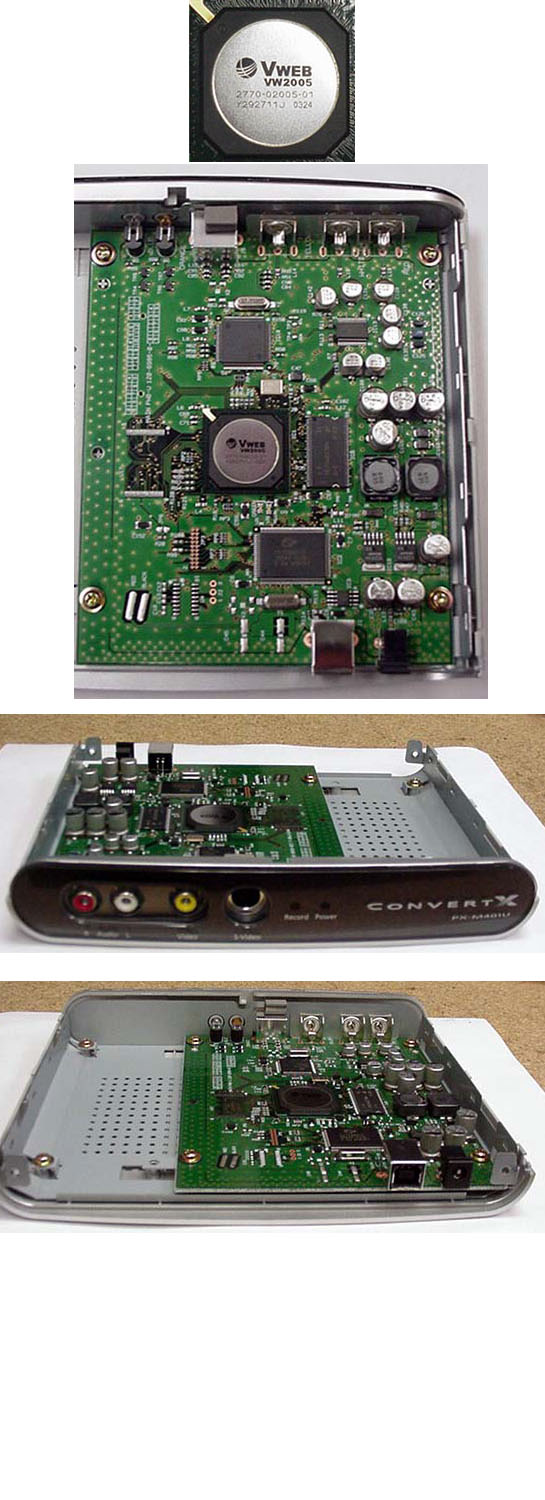

I was just told that this device uses a Vweb chip (probably some variation of the VW2005). It does mpeg1,2, & 4 encoding in hardware. |

We just purchased one of these guys to test in our lab.
The Convertx uses a Vweb 2005 chip (see attached pics). I apologize for the poor quality photos (our camera is a little dated). I thought you guys might be interested...... We have not had time to test this unit out (hopefully by next week). Enjoy! |
(poor quality photos) that look good here I figee it was Vweb chip.
