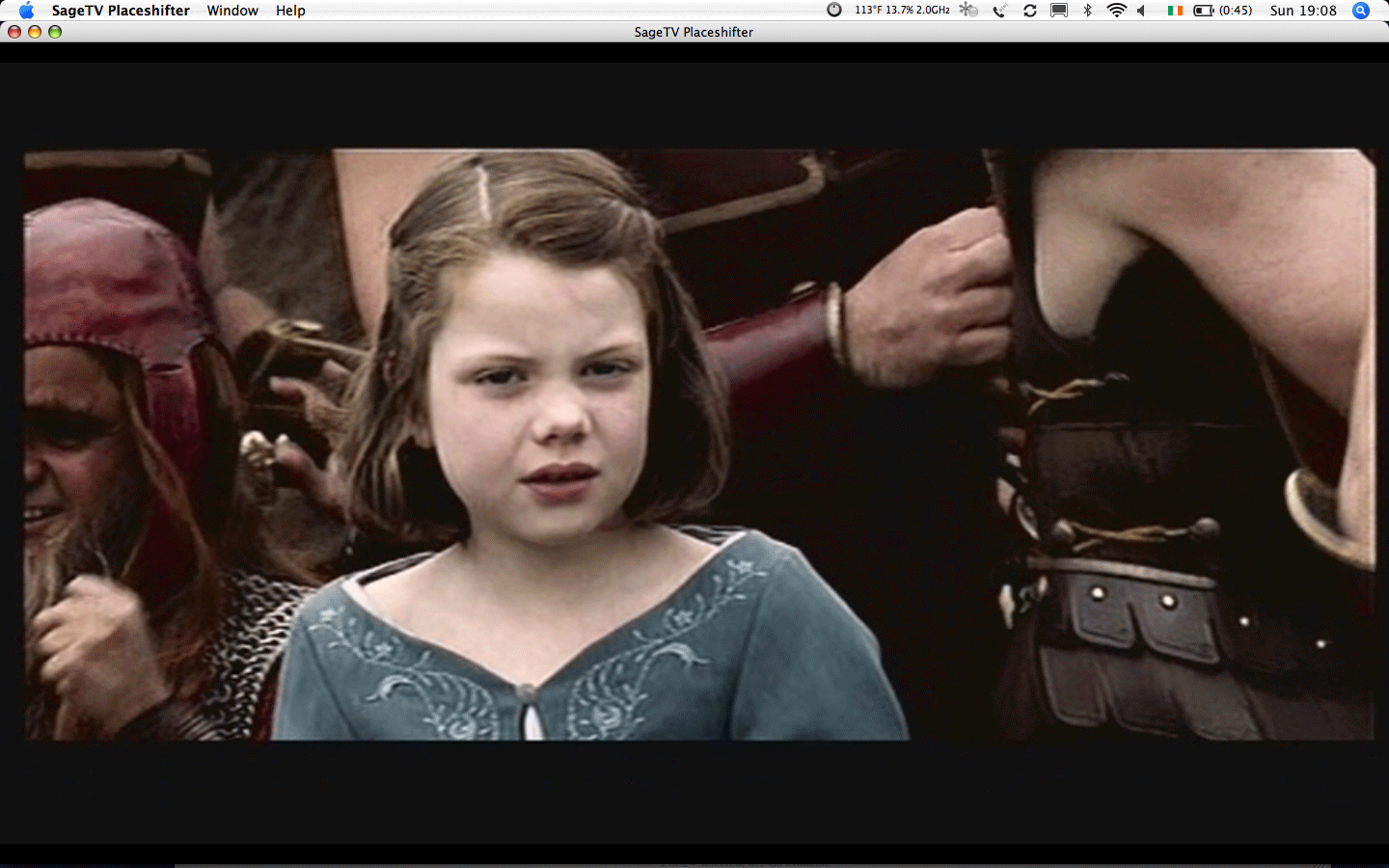

Guys
I've attached a screengrab of what I'm getting off my setup. Thoughts? I consider it poor: soft and lacking in detail. Very contrasty with poor colour. I would appreciate peoples thoughts. Peter |

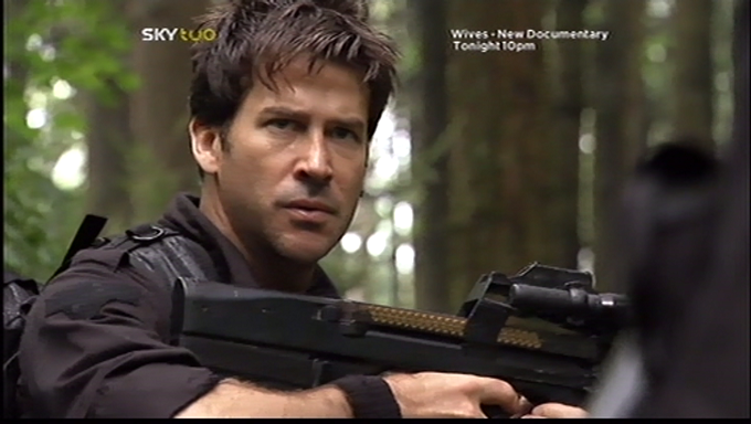

Here you go. Cannot upload the same frame as it's a TV capture.
Hope you can see some improvement here. You will, of course, miss any enhancement/degredation i see based on my TV settings and if your display device is incorrectly calibrated, the attachment may not look exactly as I see it. Howvwer, you should note from this better colour balance, better shadow detail and wider range of colours. Peter |
Fair enough. I suppose I just have fairly low expectations. Thanks for taking the time to load it up.
