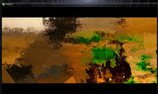

With sageTV 6.6.2 I had the same configurable options.. EVR, H.264 decoder=CoreAVC2.0 (with full hardware acceleration for VC1/AVC). With AC3filter for audio. In my client properties file, I had it set so directshow would handle playback of my media; which worked smooth as silk; just like it did in Windows Media Player, MPC, Zoomplayer, graphedit using the same filters and EVR.
All I did was directly upgrade to sageTV 7.0.18.. no hardware, driver, configuration changes, but now the same MKV based HD (x264) files when fast forwarding/rewinding I just see a snapshot of where I jumped to on the OSD timeline for several seconds before it starts to show the video. The audio continues to play in the background as soon as I jump to that part of the video. Also, it seems like complex video scenes start to garble up with huge pixelization; when it's really badly distorted, it has green pixelization included too.
I still dont have any issues outside of sageTV; since nothing changed outside of sageTV. What's causing this? IIRC, I read somewhere that sageTV 7 now uses it's own player; and may not even use hardware acceleration for H.264 videos; even if I've still specified to use CoreAVC 2.0 as my H.264 video decoder. Is this the reason why sageTV 7 has a harder time playing back these type of media? I already submitted a bug report to sageTV support; but not sure its something they can fix right away; or if it isn't something they know how to fix. Im strongly considering doing a full image restore on my entire disk with a fully working sageTV 6.6.2; and leave it there. However, it would be nice to get some kind of closure to this.
Does anyone have any good reasons why this is happening?

V7 has it's own splitter enabled for MKV's by default and some (me included) have had problems with it. Here is the info on how to disable it.
http://forums.sagetv.com/forums/show...59&postcount=3

I had to do this to get everything back to normal once I upgraded also.

Thank you!
I wish I had asked this before; or seen the post mentioned above. I spent so much time redoing my display adapter, trying different video filters; and, worst fear of all, that it was only happening on my machine which was hardware related.
I too use Haali as well for my H.264 based files with various audio formats and subtitles. I'm guessing it will be a while before sageTV comes out with a splitter as good as haali since it too years for haali to get it just right.
