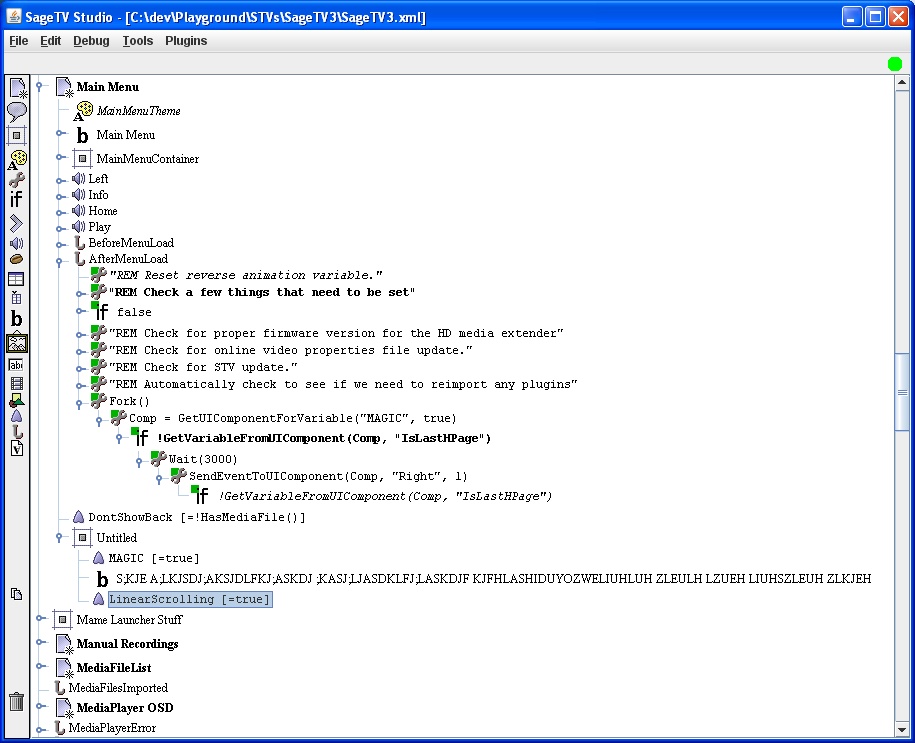

This is something that I've asked for before when version 7 was in private beta and it is possible like Plucky said above.......but be warned, its not all that impressive (my opinion).
Anyway here's how Narflex suggested doing it.... Quote:
This example is as good as I could get it but if you work something out which is better let me know..... just out of curiosity ![]() Cheers Ben

I looked at the example and if I understand it properly it will scroll that large text string from left to right and then stop. Since what I want to do is use a text input panel does that mean I need to monitor every keystroke to determine if I need to scroll the panel right (when the user enters a character or presses the right key) or left (when the user erases a character or presses the left key)? Do you need to set any special properties in the actual "Untitled" panel? Tom

Yes, if your using a panel you'd need to monitor the key strokes so you can push it back to the beginning and start over. As for the panel properties you'd need to set the scroll duration (about 350) and the drop down Animation to horizontal.....thats if I remember correctly.
I prefered using a table as you don't need to monitor anything..... it would naturally scroll around with table wrapping. I believe Plucky uses a slightly different method so it maybe worth waiting to see what that is. Cheers Ben
