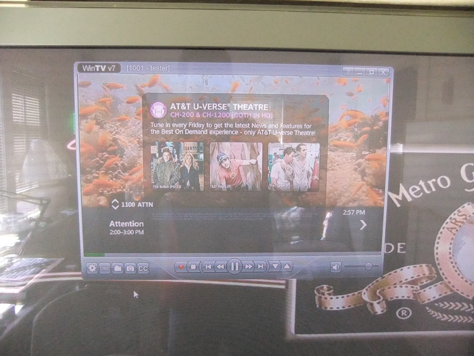

I have been working with SageTV support for a week to setup HDMI capture of unencrypted signal. They say "we don't support toslink feature" as an answer to no video! I said not to worry about audio, what about the HD HDMI capture from the Colossus card. He said "why don't you just use analog" Told him that defeats the purpose of buying the Colossus in the first place for me. Looking to capture digital to digital, encode then write to hard drive. SageTV support quote "we tried with the latest driver from Hauppauge and HDMI capture still worked fine with it. And you should also be aware that there are quite a few posts on our forums from other SageTV users that utilize HDMI capture on the Colossus card successfully" Who are these people he speaks of ?Anybody know? My current setup with STB, DVI repeater and Collosus card works to perfection with bundled WinTV 7 software (see screen shot). The exact same setup not changing one thing but running SageTV 7.1.5 shows "waiting" forever with no video when chossing Colosus HDMI source. Look closely at the picture and see on WinTV 7 UVERSE channel 1100 (HD channels are 1000 up) and sound. I'm not crazy, who has succeeded so far with Colossus HDMI and SageTV?
