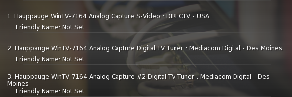

I had to wipe out my SageTV config files for other reasons, and I haven't been able to figure out how to get it back. (So I'm in the same boat as you right now.) I know before I had to basically configure four tuners -- two analog, two digital. This allowed me to tune an analog channel (say "4") and then press the channel-up button on my remote to tune a digital channel (say "4.1"), but it didn't switch the tuner. I'll try to play with it a little bit more this weekend and post results here. |
