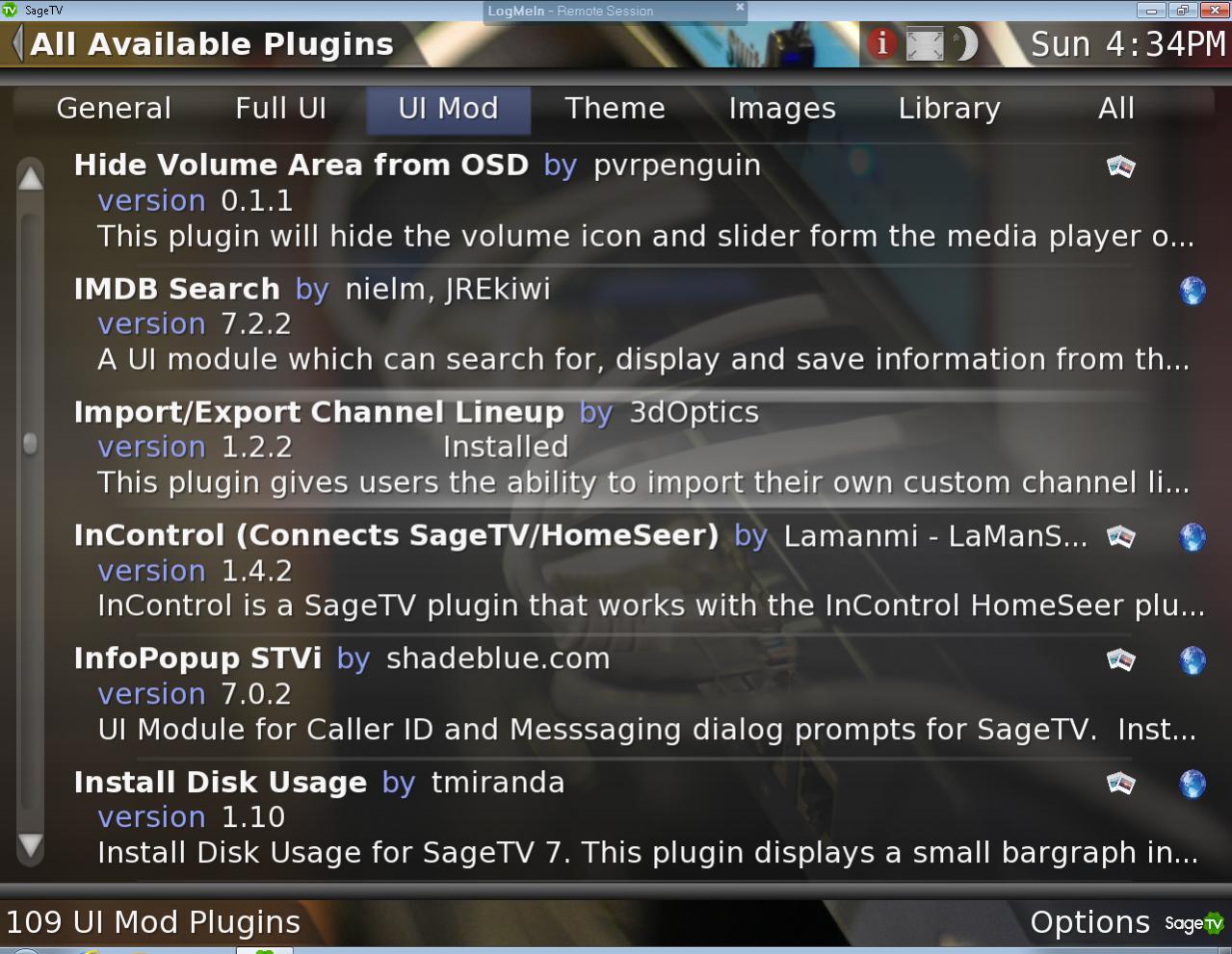

If you're using Sage 7, there's the "Import/Export Channel Lineup" plugin that I've used quite a bit. It works well, and even allows you to edit the channel lineup outside of Sage and import it back in.

Can you point me to the specific plugin? I did a search under V7 customizations but didn't see anything that obviously fit that description.
At the Sage 7 main menu, choose "Setup", then "SageTV Plugins", then "All Available Plugins", then click either the "UI Mod" or "All" button at the top of the screen. Scroll down the alphabetized list of plugins until you find the "Import/Export Channel Lineup" plugin. See attached screenprint.

Thanks, found it!
I was searching the forum for something I'd have to download. I didn't know all those were already available through the interface. After I get the channel thing sorted out I'll have to go exploring ![]() Thanks again! |
