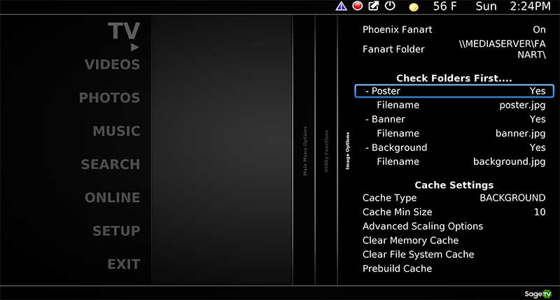

I'm dry-running a new server right now, and just playing with Fanart before I deploy this to the family.
I currently have the Cache Type set to OFF, in an effort to remove as many variables from this process as possible. My understanding is that if the fanart is available in the directory, it'll be pulled into Gemstone - no caching needed/involved. I have also cleared the memory and file system cache for good measure.
Videos/Cover Flow shows many, but not all of the posters. When I drill down to Manage Metadata, I can see the posters and backgrounds fine. I can also see all fanart via the BMT www interface. Seems to all be there and functional.
Interestingly, Center Flow *does* show these same posters that aren't visible in Cover Flow.

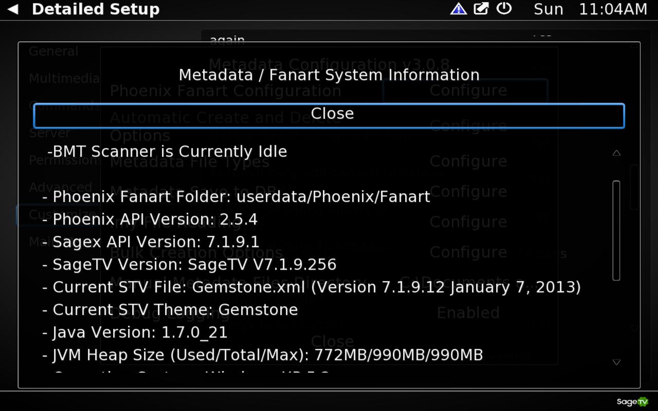

Everything should be the latest version available in the plugin repository (see attached screenshot.)
So, any thoughts why some of my fanart still doesn't want to show in all views? Might they somehow access different art?

The cache settings are really experimental power user type option. Mostly there for me as I was testing the various ways to speed up browsing. I would recommend using the default cache settings and see if that resolves your issue (background I believe).
As info, the poster in the center flow is actually a diferent "copy" of the original poster as it should not be "shrunk" as much as the wall, stage type poster flows.
I would also recommend running the prebuild for the cache.

Reverted to background cache. Deleted memory and file system cache, and prebuilt cache.
Still get same issue - specific posters don't show in cover flow, but do show appear in center flow, in manage metadata, and via BMT.
Any other thoughts of things to try?

Do you have Gemstone setup to use the folder fanart rather than the Phoenix lookup? Do you have the fanart file naming set?
Maybe some of the images do not follow the logic in the options, like "poster.jpg" etc...
No, no folder art whatsoever. It's all Pheonix central fanart folder - with the crazy names that they get when they're downloaded.
