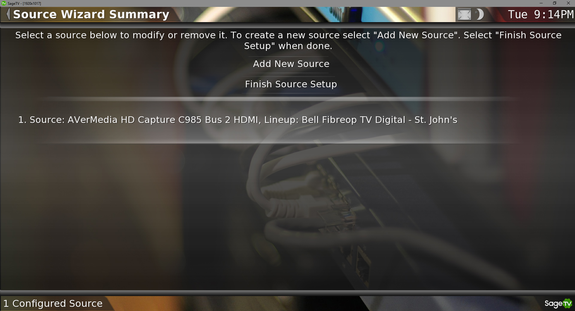

Yes I bought one and have been testing it. I'm waiting for a colossus 2 to show up that I ordered after realizing the avermedia did not do 5.1.
I tried it with sage and it shows in the list but sage crashes when I preview it.

Actually it's just black on channel preview. It's when I tune to a channel that the sagetv windows closes.
Post a screenshot of that capture device from SageTV from the source page

where that screenshot I req in SageTV with Live Gamer HD install from the SageTV source page so I whip up a registry so you test it to see if it works in SageTV with out a black/blank screen.

Oops, is this what you need?
So when you add a capture source it come up as (AVerMedia HD Capture C985 Bus 2) is that right ?.

Old 04-04-2017, 06:40 PM
SHS's Avatar
SHS SHS is offline
Location: Vinita, Oklahoma
Posts: 4,589
Download the avermedia_c985.reg.txt rename it to avermedia_c985.reg
Close or even Stop SageTV Services from running in background
DBL click on avermedia_c985.reg yes add it to your registry and reboot
Start SageTV I hope lee you setup your decoder for playback if not you may want just install the latest LAV filter any way
Any go Setup | Detailed Setup | Video / Audio it should look like this
EVR
Default
Default
Default
DirectShow
Disabled
Default
Default
Default
0
Disabled
Hope lee if all goes well you should see it working

Nothing crashes now but I still get a black screen and no signal
