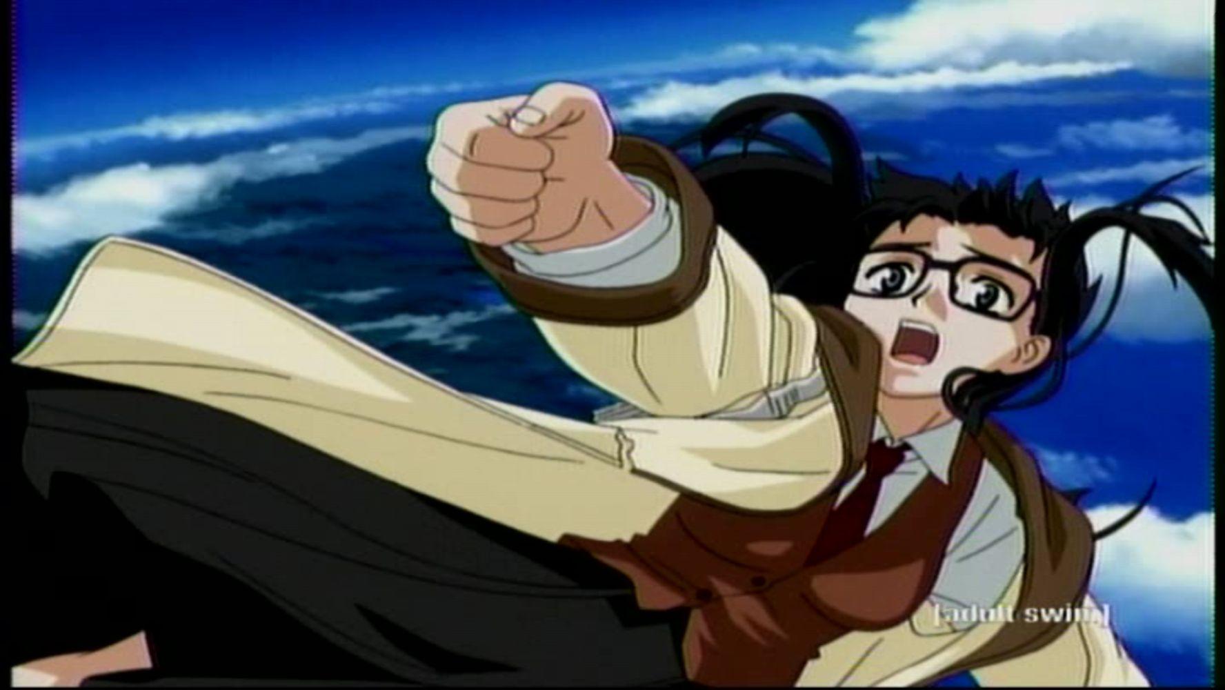

For those of you who haven't made the jump yet
![]() nVDVD 1.00.58 (4.00.58 decoders) Geforce 6800 (fanless ) 65.90 Quadro FX 4000 drivers (inf swap)VMR9 1776x1000i (46") Enjoy

![]() I think it would be cheaper for you (gas money) to just buy one yourself, what with it being a 16 hour round-trip drive and all. Oh, and for all those doubters out there, all I did was: Install the video card drivers Set them to High Quality, 2xQ AA, 16x Anisotropic filtering Install the decoder pack Set it to Hardware accelleration, Smart deinterlace control, and Pixel-Adaptive Play
