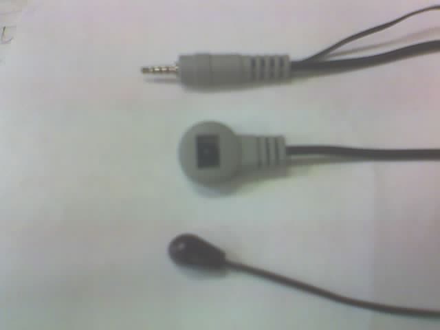

Everyone swears that the retail 150 does indeed come with the IR Blaster, though no one has been able to provide me a pic (even on SHS' forum)
The 150 comes with a remote + IR receiver/transmitter. The 150MCE and 500MCE do not.

What sort of pic would you like? I have attached one of the IR cable that comes with the 150 (sorry about the quality, took the pic with my phone). You can see the receiver and the blaster portion. Let me know if you wanted something else. |

Better late than never: http://www.lyberty.com/tech/pvr/pvr150/ This page shows a retail version I picked up Jan. 2, 2005 from CircuitCity (California). IR Blaster is the 5th photo. [edit Jan. 16 05: removed qestion about IT blaster problems. Problem is more complicated than implied, and best described on new thread.] Last edited by lyberty; 01-16-2005 at 09:05 PM. Reason: removing question about Blaster problems: topic for another thread |
Nice page lyberty
thx
Glad you posted too, cause now I know what "SHS' forum" is! (So many forums, so little time...) |
