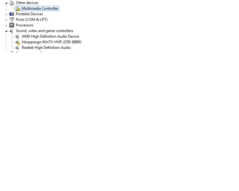

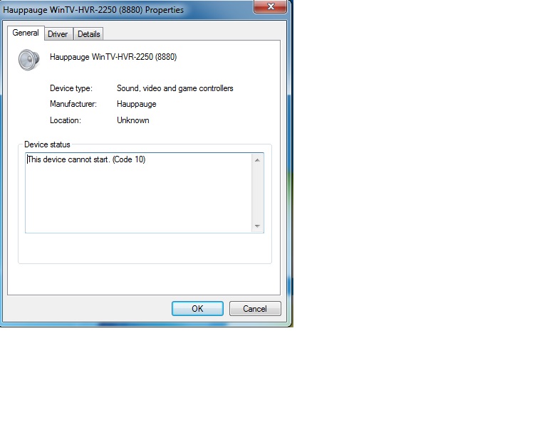

Tested a PCIe video card today in all 6 slots. 6 for 6 that the video card was recognized. That equals, slots are good. Now I am looking for another system to test the cards in to confirm or rule out bad cards.
Cards show in device manager. Sometime like the attachment, where their is an issue and they have a "Device Cannot Start: Code 10". This is the most common outcome.

Forgot to include this screenshot as well.

Have you tried running the HWClear app and re-installing the drivers for the card yet?
Those screenshots indicate that Windows can see and recognize the card, it just can't get it to work.

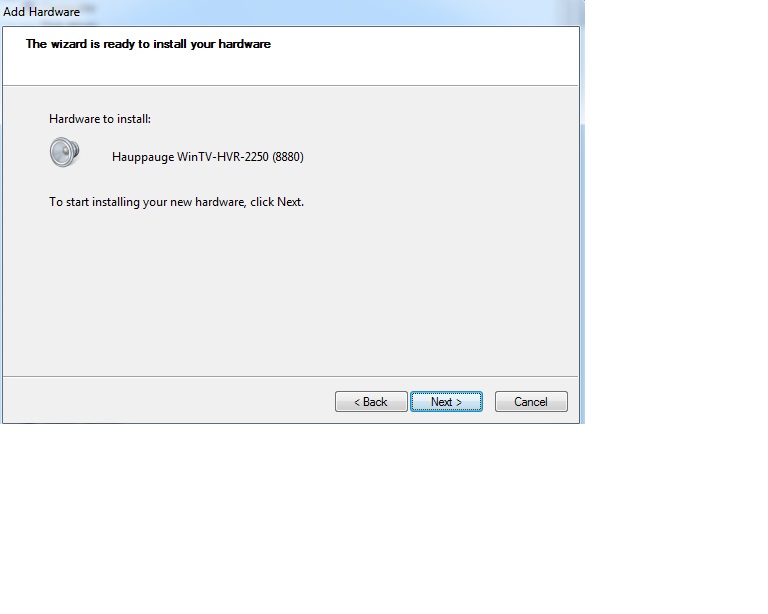

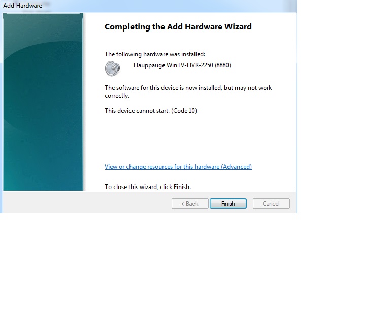

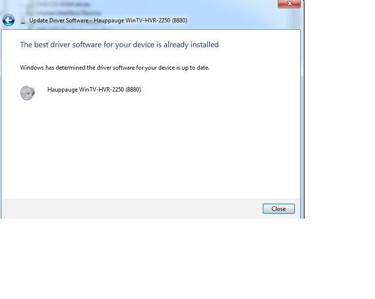

yes sorry I didn't include that info previously. Have done that a couple times.
Basic process is as follows:
Run the clear.
Reboot
Run driver89_7_9_1_33006
Reboot (nothing)
From Device Manager
Update Driver Software
Then "search automatically"
Attached a screenshot of what I see after this.
So then I try to add Legacy Hardware (because the cards are at least 4 years old) and why not.
I point it to my drivers on the HCW3_4_26249MCE CD.
I will attach several screenshots that show the process that leads to nothing ness.

I will follow them exactly step for step tonight as I don't remember the part about Win7 recognizing them then changing drivers.
I do notice that it tries to install the "multimedia controller" (from 1 of my pictures) and fails that.
