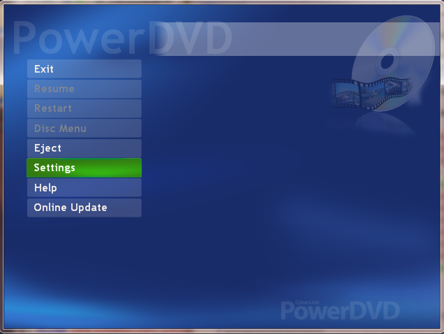

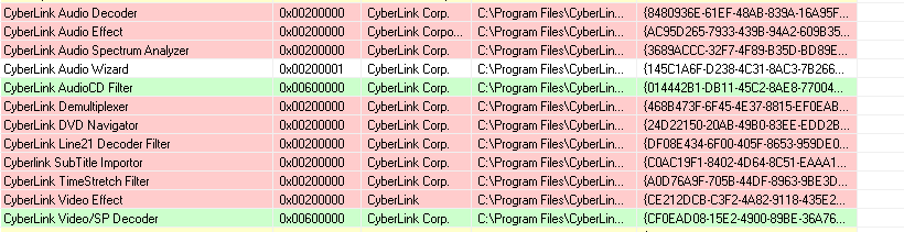

I purchased and installed PowerDVD 8.1. I'm trying to find the H.264 codecs.
DirectShow Filter Manager shows these Cyberlink codecs:
None of these look like H.264...
Also I tried to run the PowerDVD program to test and see how well it did on its own playing an H.264 file from the HD-PVR. However, I cannot figure out how to get it to play a file on the hard disk. There is no apparent means to simply play a media file.
Here's what the UI looks like:
It is nothing more than an emulation of a physical DVD player. It is as if the concept that video could exist in any form other than a physical DVD has never occurred to Cyberlink.
Is there some trick to get it to play a file? Drag and Drop does not work.

I'm not sure about the filters, but when I was using powerdvd it was called the AVC filter.
Also, that interface looks nothing like the powerDVD 8.1 interface that I recall. Maybe it's some stripped down OEM version? Where did you purchase this copy?

The Cyberlink H.264 Decoder is only available in the Deluxe and Ultra versions of PowerDVD. It is not available in the regular version.
