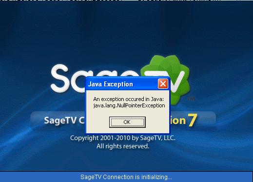

Trying to get Sage7 working on Linux 64 bit. I downloaded the 32 bit JVM from Oracle and installed it in to /opt/jre16. I set up my sagesettings file as:

When I try to login from my windows client, I get a NullPointerException. This is what causes the log entries in sagetv_0.txt.

Do you have an active license? That says your Wiz.bin file is corrupt.

I do have a license and set it up the first time I started sage. Every time I start up it says that the Wiz.bin is corrupt. I can delete it and it still says it is corrupt.

Everything looks kosher there. Also, I am starting the server as root.
Old 10-15-2010, 01:36 AM
bcjenkins bcjenkins is offline
Posts: 3,764
Recently I was doing some environment settings with my sagesettings file. In order for the settings to work correctly, I had to use export instead of just the settings. Perhaps you should try:
export JAVA_HOME=/opt/jre16
export PATH=$JAVA_HOME/bin:$PATH
Also, I didn't/don't have #!/bin/bash as an interpreter set.
B
PS - I was able to confirm this was needed by echoing my variables in startsagecore
Running SageTV on unRAID via Docker
Tuning handled by HDHR3-6CC-3X2 using OpenDCT
Old 10-15-2010, 08:22 PM
adler187 adler187 is offline
Join Date: Oct 2010
Posts: 8
I exported the variables, but that didn't help at all.
Both were already exported on shell startup, so they didn't need to be exported again.
I checked with export | grep JAVA_HOME and export | grep PATH.
I uninstalled and reinstalled the client from my PC to see if it was problem with the upgrade from v6 of the client, but still no dice.
Old 12-05-2010, 11:59 AM
Join Date: Oct 2010
Posts: 8
Well I finally had some time this weekend to mess around with this more. I installed openSUSE 11.3 32 bit in a virtual machine. This had the same issue, so it is not a 64 bit problem. I also tried the latest openSUSE 11.4 milestone and Fedora 14. Both had the same issue as well, so I'm not sure what the problem is.
Edit: This was also using the latest sagetv 7 release.
Last edited by adler187; 12-05-2010 at 12:15 PM. Reason: note that sagetv has been updated to latest version
Old 12-05-2010, 05:32 PM
Join Date: Oct 2010
Posts: 8
After a lot more messing around with a Linux Mint VM and the deb installer, I found the problem. I deleted the key and the public/private keys and re-activated.
Apparently, the first time I activated, something messed up or somehow the key got corrupted. This was causing Sage to crash. Perhaps it was due to the 64-bit JVM I was using when I installed initially.
I also noticed that the deb installer creates two directories in /opt: sagetv and sagetv7. The sagetv7 directory holds STVs and ChannelLogos directories, as well as Wiz.bin* files. I see all these files in the sagetv folder as well, so not sure which copies are used. Also, the sagetv files were not stored directly in sagetv, but in sagetv/server. I'm not sure if this is how it is supposed to be installed (or if it matters), since the tar.gz file doesn't contain a parent directory, so the files get extracted to the current directory (which is pretty poor form...).
