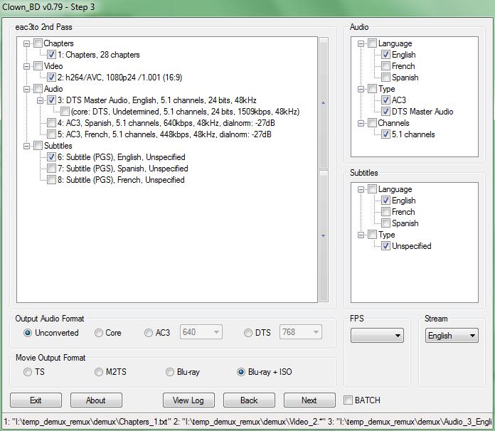

In my setup the core is not being passed through.... If the only selection on the blu-ray is DTS-MA, my DTS receiver lights up with 'error' on the front panel. It will pass AC3, but only if the blu-ray has it. The two titles that I'm working with are "Date Night" and "Knight and Day". "Salt" worked OK. All play perfectly on the PC with PowerDVD 9 (included with the burner).
Maybe I'm missing a codec? In the attached pic, clown_bd says the 'core' is undetermined, and it won't let me check the box.
Larry
Larry
What you want to select there is the DTS-HD MA track and leave "unconverted" selected below. I believe the other options (AC3, DTS) will create additional either AC3 or DTS tracks from the audio track you selected.
It kind of sounds to me like you've got an HD200 and you've got it set up for PCM or analog output rather than Bitstream. The HD200 can't decode DTS so you get nothing from DTS tracks.
This is where I was in the land of lost codecs... Selecting 'unconverted' left me with no sound, selecting AC3 worked with sound but not 5.1, selecting DTS gave me a missing codec error (arcsoft and surcode, spent days tracking those down). They only create one audio track, but that could be me doing something wrong.
