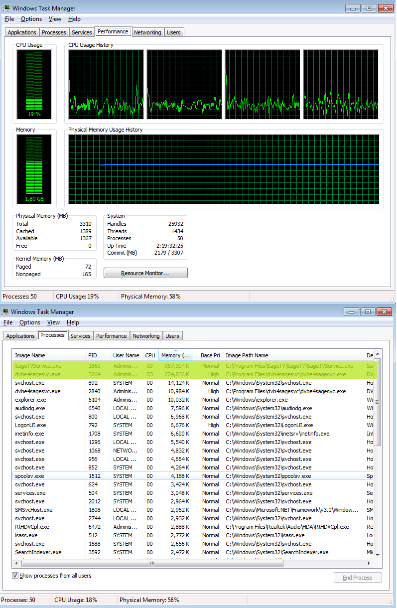

i run 7 extenders, with windows embedded 7 32bits, computer with 4GB, available 3GB to windows. no page file.
motherboard+fanless cpu
right now i run concurrent 4 extenders and record 4 channels - look at memory footprint.

If you are running a 32-bit version of Windows (XP, Vista, Win7), even if you install 4GB or more of memory, it will only recognize a little less than 4GB by default. So, the drivers generally work OK on 32-bit OS's.
If you are running a server version of Windows, there is an option to enable address extensions that will let a 32-bit OS see the full 4GB of RAM. It may be possible to do something similar with non-server versions of Windows too (I'm not sure on this). If you do this, the Hauppauge PVR drivers choke.
If you have a newer HVR card from Hauppauge (e.g. HVR2250), they work correctly with 32-bit or 64-bit Windows and they can handle more than 4GB of RAM installed.
