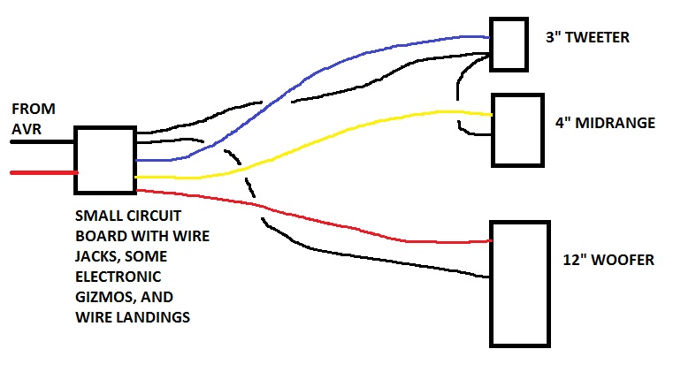

I have some old speakers from a rack stereo system, from the mid-90s. They are from the era of "big floor-standing speakers that are like furniture", with a nicely-finished wood box. However, as we don't have much room in the place I'd like to put them (see my other thread about my home theater plans), I would like to reuse the "guts" in a much smaller box, or maybe even as ceiling speakers in the dropped ceiling tiles of the room.
The main speakers are 3-way, 8ohms, 140W max. See the attached sketch for the wiring inside. Safe to say that blue, yellow, and red (the actual colors of the wire insulation, BTW), are "hots" and the blacks are neutrals.
That old system did not have a subwoofer - the woofers in these speakers took on that role. However, my new system will have a subwoofer. So:
1) If I buy a new (separate) subwoofer, could I simply snip the wires to the woofer, and reuse the midrange/tweeter together, with that same wire jack circuit board?
2) If so, is there any way the woofer(s) could be repurposed as a subwoofer? I skimmed the wikipedia article about woofers and it sounds like there's a LOT more that goes into woofer/subwoofer design than a speaker mounted in a box - but then again, I'm not an audiophile at all and I could reuse the large speaker box for just the woofer (since it's designed size-wise for the woofer) if my idea would work.

Since the speakers are 3-ways, and the crossovers are designed for that, I think you'd be very unhappy using just the mids and tweeters without the woofers. Typically you'd see the crossover point between woofer and mid at somewhere in the 500hz range. That is unfortunately well into the human speech ranges.
Your mids were probably not design to go much below that either. So if you managed to change crossovers to suit a 2-way and tried to use the mids for normal satellite range, you would probably damage them, as satellites and subwoofers usually crossover in the 80hx to 150hz range.
Lastly, the old woofers might be usable as a sub, but the box volume (internal dimensions) need to be correct for the speakers. You would need the original specs for those woofers to real get the box size right.
Honestly, you'd be better off selling them and getting more suitable replacements.

Or mount them in the garage for some nice music out there. Seriously, if you are going to have a subwoofer, then there is no need for the large woofers used in older 3-way boxes. I'll second the recommendation to move to a newer speaker system, once that is more in tune with a home theater (mids&highs all around, and the sub providing the non-directional lows). Personally, I've got a set of Yamaha speakers that have 4 4-inch mids w/ a 3/4 inch tweeter at all corners. I think each speaker is 120W, but that is a lot of power for just mids-highs. I believe is the model number for the set. is NS-AP9500. They are an old speaker, larger than most systems for sale now, but I did just look it up and there are some of these for sale on Overstock.com for a VERY low $135 (Yamaha NS-AP9500 6-piece Surround Sound Speaker System) They pair perfectly with my Yamaha YST-SW030 sub.

Thanks guys. I had a feeling it wouldn't work, but I just wanted someone to tell me for sure.
