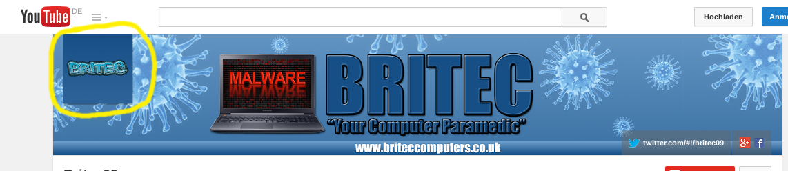

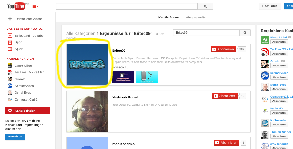

I don't know a way to get the needed Image-URL via YoutTube-API so I simply grabbed the Image-URL which is referenced when searching a tube channel or on the channel homepage - see attached examples.
In case of Britec09 the URL is: https://yt3.ggpht.com/-CTcYtDU60LQ/A...k-no/photo.jpg
It's working without SSL as well and this is the way I used in CustomOnlineVideoUIText.properties:
http://yt3.ggpht.com/-CTcYtDU60LQ/AAAAAAAAAAI/AAAAAAAAAAA/VF-__almB54/s100-c-k-no/photo.jpg
