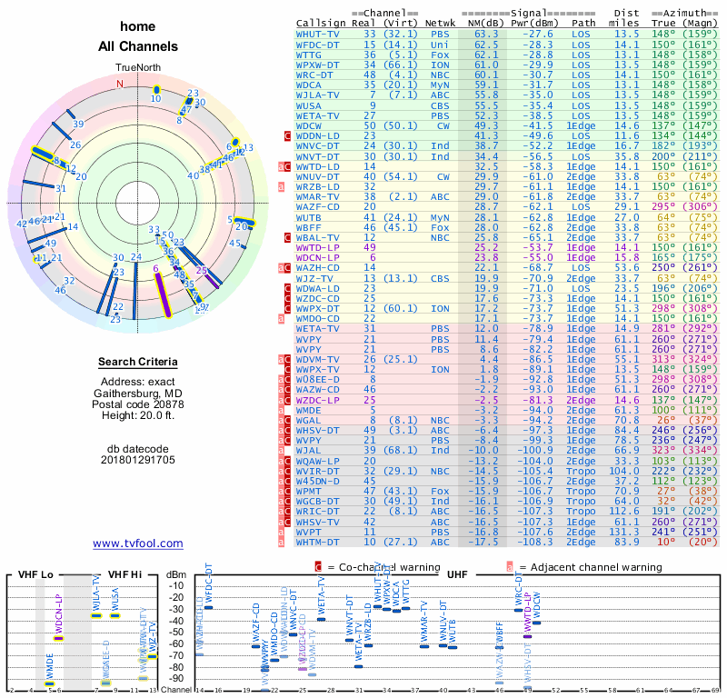

I'm not that far from the broadcast antennas (<15 miles), but I've got a brick house and all my jacks are on interior walls away from windows. So, I don't have a lot of placement options for indoor antennas. I tried putting a ClearStream Eclipse in a first-floor window, which is the only place near a jack, but I don't get a reliable signal there. I should have had the electrician run a cable to my attic when he ran the other coax and ethernet lines. I think there is a relatively straight shot up from my air return, but I know it took some effort on their part to use it. |

It seems like it shouldn't take a lot to get a usable signal. TV Fools thinks I should have been able to get away with small indoor antenna, but I suspect a combination of my brick exterior and a large tree directly in the line-of-sight is my problem. I can see where the electrician dropped the CAT6 and RG6. It seems like a long way to go, though. |
I'm not a fan of ClearStream product to me they don't work will I know some people that have got there prodoct I take look at ChannelMaster ULTRAtenna 60 or the EXTREMEtenna 80 and other like the DB4 and DB8 Used good quality cable like RG6 tri or quad shield easy to get off ebay with out buying a big roll just Order the ChannelMaster Coaxial Connector Installation Kit this come from PCT International who make very good quality stuff and tools in fact a lot of product from Channelmaster are made by them Also this will help give idea https://www.google.com/search?q=tv+a...h=1021#imgrc=_ |
I've attached the TV Fool report for my location. In theory, it should be pretty easy for me to get a good signal, but as I said before, a basic indoor antenna didn't cut it- the signal kept cutting out. I'm a little concerned about the high-band VHF channels. VHF antennas look huge. Even the CM-4228HD looks big. The CM-4221HD might be a good option, although VHF gain is only 3.5db. I'm hoping just by moving the antenna into the attic I'll get a stronger signal. Last edited by reggie14; 11-29-2018 at 10:42 AM. |

I'm growing increasingly convinced the VHF channels are going to be huge problems. Mostly as a test (since it involved running ethernet across the floor of a room), I moved my small window antenna to a window on the second floor, basically 8 feet of so below where the attic antenna would go. I actually got a worse signal on the VHF channels than on the first floor, likely because of the tree. So, if I'm going to do this, I think I need something with more VHF gain. Unfortunately, those are all pretty big. The CM-2018 seems to be one of the smallest antennas with a 7db+ VHF gain. I think that will fit- I just worry it will be awkward up there. Do you have any other recommendations? |

It's a convenient size. I just worry that a ~4db gain on high-VHF isn't going to be enough, given my test with the window antenna. I really don't want to do a roof-mounted antenna. We had one of those when I was a kid and we regularly had to reorient the antenna after it moved in the wind. But that was a one-story rambler with a relatively flat roof. I'm not going to go up on the roof of my townhome . Last edited by reggie14; 11-30-2018 at 12:22 PM. |
I live in the western DC suburbs (Loudoun) and set up an antenna (ClearStream 4MAX) in the attic pointing generally northeast into a line of trees and I still get 67 channels with my Quatro. Even a few Baltimore stations. You might be surprised how well the attic antenna works. --John |
